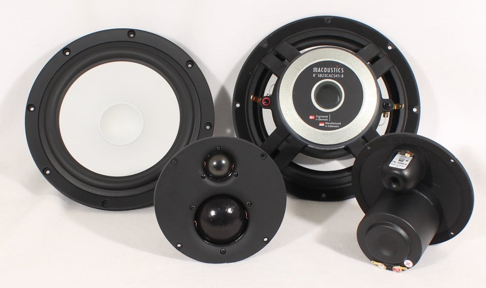

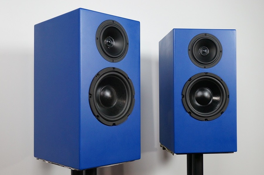

Any audio enthusiast in North America who has ever flirted with the idea of building their own loudspeaker will know what Parts Express is. It is the leading supplier of components and DIY audio gear in North America. Audioholics has done a lot of reviews of Dayton Audio products, a brand owned by Parts Express, but we have only ever dealt with their finished systems. Today, we are going to get some grease on our elbows and attempt to tackle one of Parts Express’s DIY kits: the Orian 3-Way High Output Bookshelf Speaker. While we mostly deal with finished products, we have long been toying with the idea of reviewing an unfinished kit speaker. Audioholics noticed the Orian design in our coverage of the 2023 AXPONA, and we found the design so interesting that it has finally pushed us off the ledge into covering a DIY kit speaker. As its full name indicates, the Orian is a 3-way bookshelf speaker that promises lots of displacement. It’s a large standmount speaker that has a coaxial driver for the midrange and tweeter and a beefy 8” subwoofer driver for bass. The chamber for the midrange cone is open so that it has a partial dipole acoustic radiation pattern. What we find appealing about this design is that it should be a good full-range solution for near-field listening due to the coaxial driver and good as a typical stereo or home theater speaker due to the amount of air displacement it is seemingly capable of. How well does it accomplish this? That is what we intend to find out — assuming we don’t screw up the assembly process. Read our full review to learn what we found...

Great job on the build. Was good to see a review on something other than yet another, 5" bookshelf speaker. It is also good to see a true full range assessment with 2 channel. I think the paint came out great.
I'm a huge fan of DIY and I think this is where we can break from designs that are otherwise overplayed with trying to satisfy everyone, and every listening setup for mass market appeal.
8" is a great all around monitor size IMO, especially for potent near field performance. I currently have a pair of 8", 3-way, JBL studio monitors on their sides, 4' apart, on stands on either side of my PC desk. I'm just 2' back from them and pointing at me. As an audience of mostly one, I could live with this setup forever, for music, movies and gaming, room be damned. Talk about mid bass slam. This is one way the poor man can get that effect rather cleanly while on a budget, other than trying to set up a whole room for it and while not irritating the neighbors so much.
I looked at this design when it came out but I have way too many speakers now, and a few pairs that kind of fit in that category.

Great to see a review on something other than the standard retail models. Nice job on your first build.

I have some comments. First the negative. I have looked at the data on those drivers, at least in a preliminary fashion. It am pretty sure that box is an extended bass alignment. I would have gone for a higher F3, and a smoother bass response. In the commercial world low F3 takes preference over bass quality. That is generally the wrong trade off.
The encouraging thing is that the cone of the midrange driver is covering the speech discrimination band. In the realm of HT that is a huge plus.
The tweeter response is a bit rocky. That tends to be a characteristic of coaxial drivers, because of cone reflections of the tweeter output. However, as you pointed out, they often end up sounding a lot better than you might expect. Getting a good tweeter response is a big challenge working with coaxial drivers.
So one question I have, is how does human speech sound, especially male speech?
I have looked at the specs of those drivers, and their parameters seem well chosen.
The midrange is low Qts, at 0.28, so if you don't like that rear radiation. you should be able to stuff that rear cavity with damping and close it.
The woofer looks particularly interesting and attractive. So I am going to doodle with that in the coming days.

Anyone he wants to build this would do well to buy it soon. On the site I found that they listed the wrong midrange driver. When I went to do a model I found there was not a coaxial driver. On further investigation I found that the mid/tweeter coaxial driver is now discontinued. So it seems that the remaining stock has been earmarked for that kit.
I also found out that the mid is actually a very high Qts driver, and that is why they did not close it up! Its Qts is 0.7.
So I think there is no point in me modelling those drivers.
This is unfortunate.
