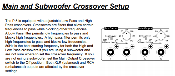

Yes, just what I was thinking...Here is a small section from the P-5 preamp manual, showing the bass handling controls on the rear of the preamp. (There much more explanation included in the manual.)

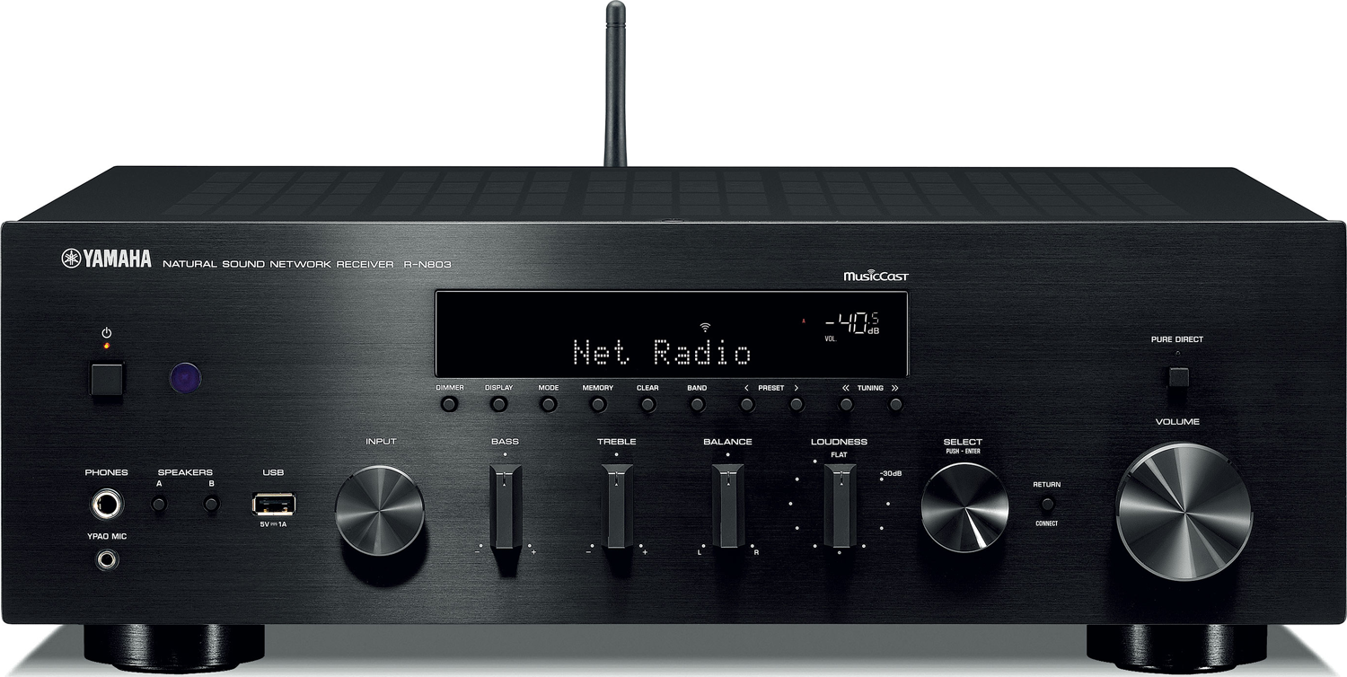

The other option I am aware of is the $750 Yamaha R-N803 which is an interesting cross between AVR and tradition Stereo Receiver that gives you Yamaha's RoomEQ (YPAO) with full AVR bass management and EQ, along with automated level and delay matching:
https://www.amazon.com/dp/B0758NXS8R/ref=olp_product_details?_encoding=UTF8&me=
At 100+ Watts per channel, these both have ample power to ensure you can play the Forte's louder than you could ever want.
As LovintheHD said, AVR's get you more for less, but if you really want to avoid an AVR, be it for looks or not having a screen attached (I'm not sure how the R-N803 shows you where you are, but it doesn't have video out, so they must have worked it out on the display window!).
Buying an AVR would get you Video processing and 3 or 5 extra amp channels (along with audio processing for multi-channel options) for roughly the same price as these stereo receivers! But if you are certain you won't use those features, they have little worth to you (and modern AVRs have too many buttons and not enough knobs! :D).

Yamaha R-N803 (100wpc, lots of features) above
Yamaha A-S801 (Same power, much less functionality) above
Why do you do it, Yamaha? I was amazed at how much "more" the R-N803 seems to offer for less money. I was rattled by the cost/feature discrepancy. Why is the Yamaha A-S801, with less functionality, $150 more than its brother receiver? I found a couple of extended threads on other forums discussing this same question, but ultimately no clear conclusions.
