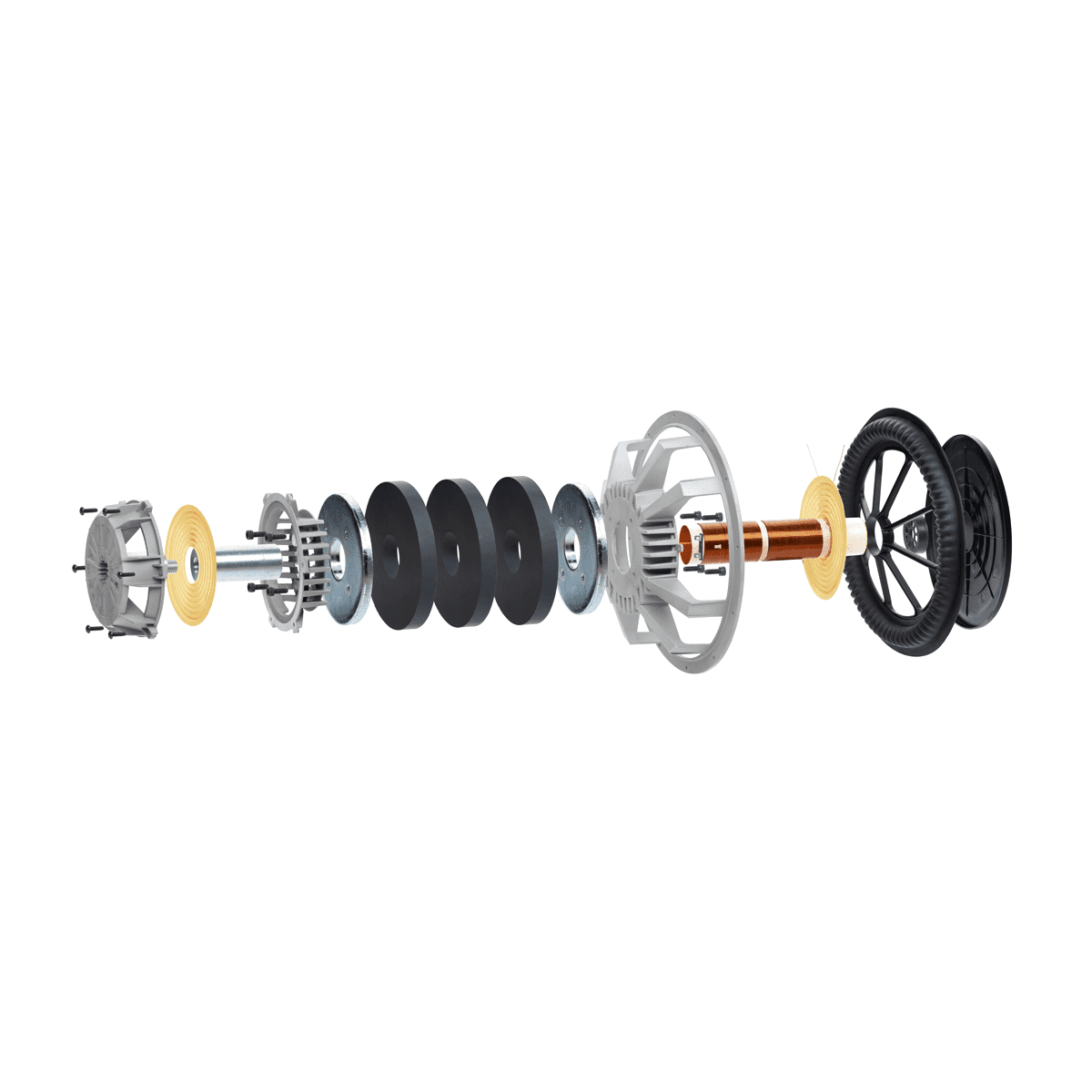

Honestly, I doubt Paradigm is making a sub/driver like this:
IMO the Seismic 110 and E-Sub 110, while dissimilar, are still probably the most similar drivers on the market to each other. Paradigm's magnet stack is in the middle of the motor assembly (in between the 2 spiders), but they both have deep motors with spiders spaced several inches apart which is unique to those 2 drivers as far as I know. When the E-Sub came out my first thought was that JL took some inspiration from Paradigm's driver design.
Paradigm shaped the Seismic's aluminum cabinet so the driver would take up the whole face and JL just made the driver mounting flange the size of the entire front baffle.
