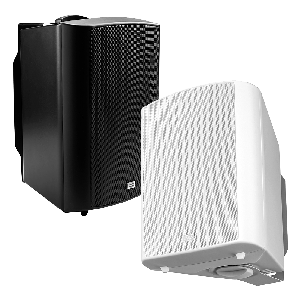

Hi,
For a low cost, here's a little setup that won't break the bank and is solid on its own.
OSD AP640 pair
Fosi BT10A Amp (has bluetooth, or any analog RCA intput)
