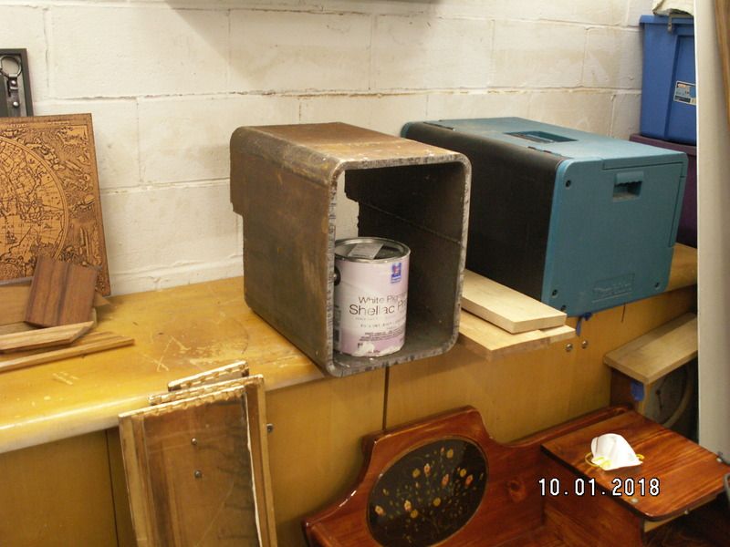

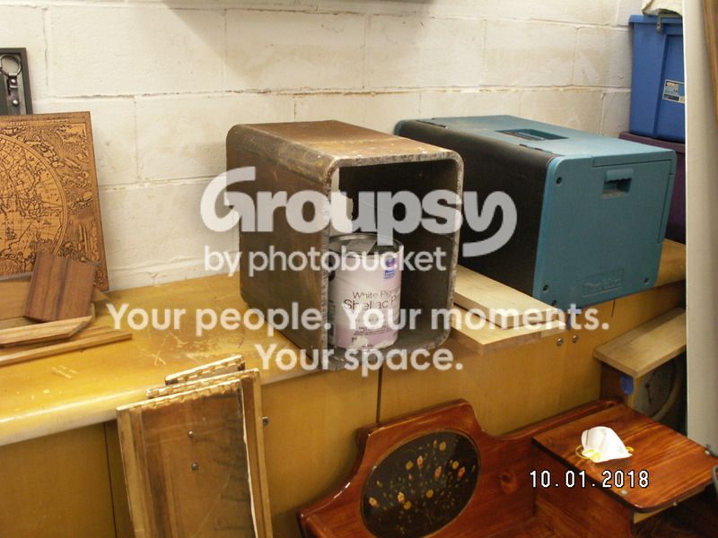

The steel with a 1 gallon paint can. It's gonna be a shelf. 16x12 outside dimension.

PT and metal work? Working hard to make us look real lazy.
  • Funny
Reactions: Alex2507

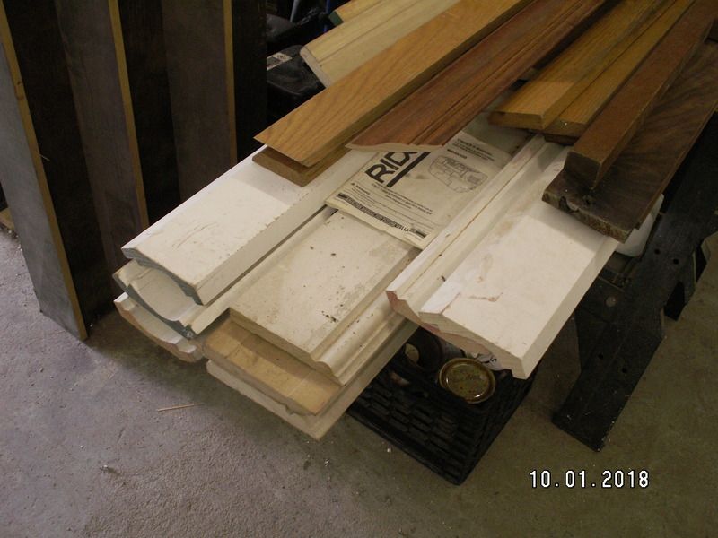

I'm not sure where the distinction lies but that is steel, as in Man of ... . I got the crown molding and base board sanded up for spray. The crown only had primer and that should come out mint. The base already had latex on it and the boards stuck to each other so it's gonna look a little rougher but that's fine. I want the crown to sing.

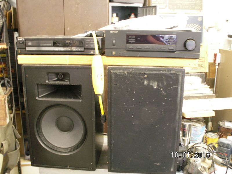

EDIT: That's Eddy's garage. Somebody sold him 4 of those horn speakers for a c note. They sound terrible.

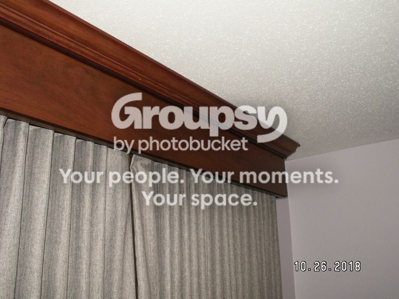

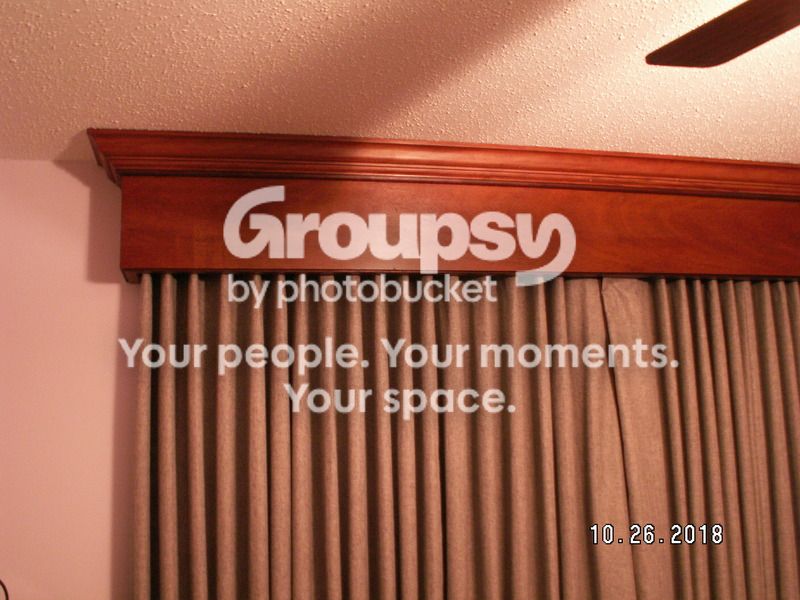

In other junk news ...
Low light so flash ...

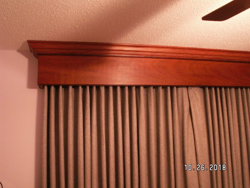

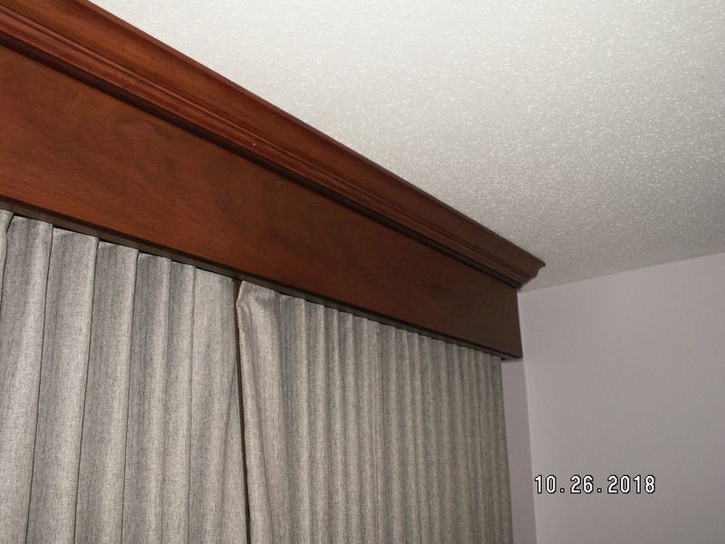

Straight out the dumpst-ah. I had the valance built before the knee replacement. It's been hanging around evah since.
... and it's still not 100% finito. I need to install the rods but that screw is so small and my fingers are so big and the clearance for a screw driver only leaves enough room for a bit, a short one at that.
I was going to make it so I could do pull ups on it but the ceiling attachment is a series of toggles through double 5/8. I saw how they screwed the rest of the drywall off and worried that I might pull the whole ceiling down. I can't do pull ups anyway, let's not kid ourselves.
