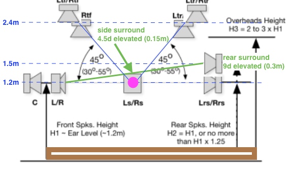

Well, yes. It does matter, to a point. Since any new formats are way out for the foreseeable future we’ll ignore that.
In a traditional 5/7.1 channel based system the standard procedure, and what worked best for me was with my surrounds about 6’ tweeter height. I think that was about 30-35° above ear height. L/R tweeters at about 39”.
For immersive audio, the guidelines(they are just guidelines, not hard fast rules as Atmos for example is fairly forgiving) say that the surround speakers should be at about 1.25 times the height of the Mains. See below
That image(side view) is modified from Dolby’s literature to show a slightly higher surround speaker height. This is to get the tweeters above the heads of other listeners if you normally have a couch full of people. My side and rear surrounds are at H1 x 1.47. That places them at about 57”. Slightly higher than I wanted but that height works and I didn’t want to relocate a 3 gang light switch box.
Here’s Dolby’s much more in depth literature than what you’ll find on their site currently.
https://www.dolby.com/us/en/technol...tmos-home-theater-installation-guidelines.pdf
The reason Atmos works, and how it was designed is to use the height differential between the bed and height layers to phantom image the “objects” into the room. This also helps create an “Atmosphere” of sound. Legacy setups like 5/7.1 benefitted from higher surround speaker placement by kind of splitting the difference. Being able to convey sound effects that would be higher, and at ground(ish) level too.
FWIW, IMO if you’re considering atmos, go for it. Even older titles can benefit from DSU and DTS-NueralX. I’m currently watching Bourne Ultimatum with dts-NX and it’s fantastic.
In that case I would recommend your current path of finding stands for ear level surround tweeters, as that will carry you toward atmos later. Even if you don’t do atmos, the lower surrounds can work just fine as lovinthehd has enjoyed that as well as many others.

With adjustments, my mains will have the top of the cabinet at about 49.5"H... tweets will be centered about 45"H. I am not concerned about that 4" difference.
I also have my Rear Surrounds wall mounted above a closet instead of on level with my Bed Layer. Acoustic Center is ~85"H. They sound fine. Work Great. I will add Atmos within the next few months and will call current Rear Surrounds Rear Heights, Top Rears... or keep them as they are in a possible 7.3.4 set. Or 5.3.4.
