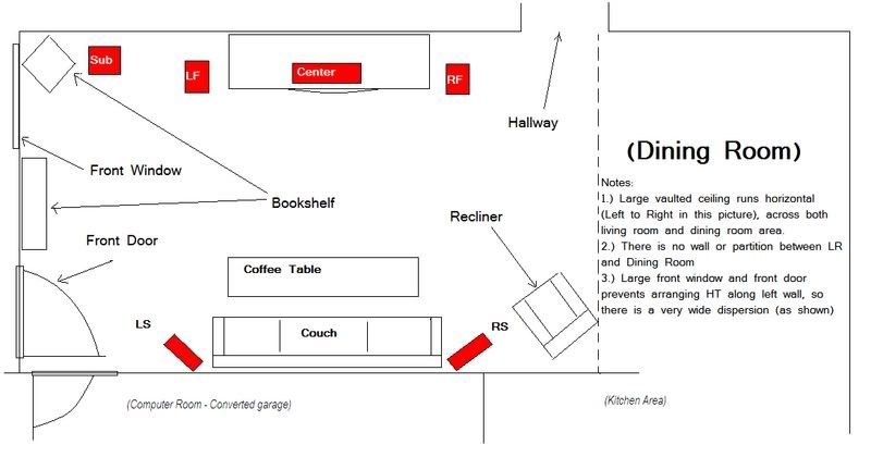

HA HA, yeah, very linear!
Feel free to draw up a rough sketch of your room so that I can give some placement advice.
Sincerely,
You've got it. Here it is.
