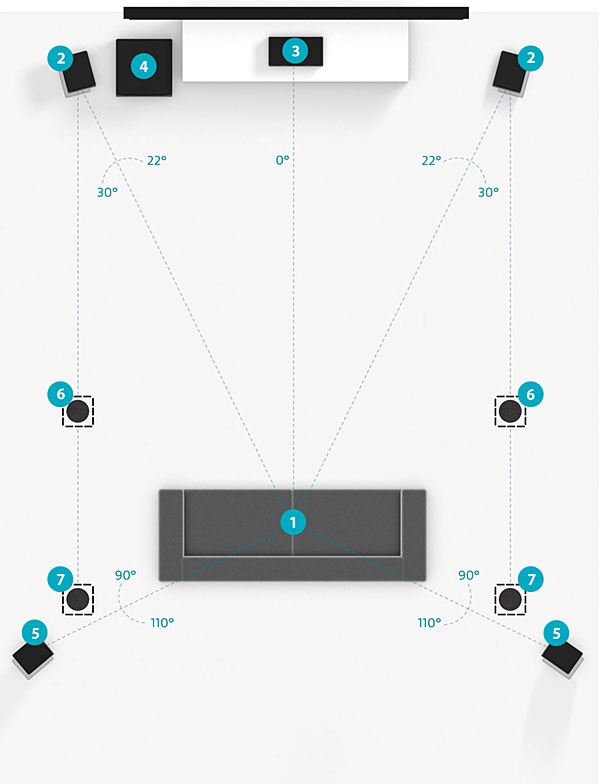

I always find it hard to follow people’s descriptions of where the stuff is in the room but it sounds like you need some help with placement. From the quantity of speakers you bought it sounds like you might be going for a Dolby Atmos system. Or maybe not? For a traditional speaker layout start here.
This shows a 7.1 system but you can remove the rear surrounds and slide the side surrounds back just about 18”-24”. In this system it’s ok to have the surround speakers up higher. 6’-7’ is about all though. They will image more closely to what’s on the screen that way, and too close to the ceiling could cause some funny reflections. The front 3 speakers though, should always be on the same plane as the screen. Obviously there are deviations that work, but not as well.

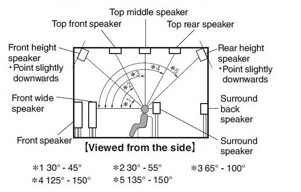

For an Atmos system, you’ll need all of the speakers at roughly ear height, except the Atmos height speakers which would ideally mounted in the ceiling close to spec. If you don’t want to mount them ON the ceiling, “front and rear height” are positions that are supported which will place the height speakers where the front and rear walls meet the ceiling. Image below.

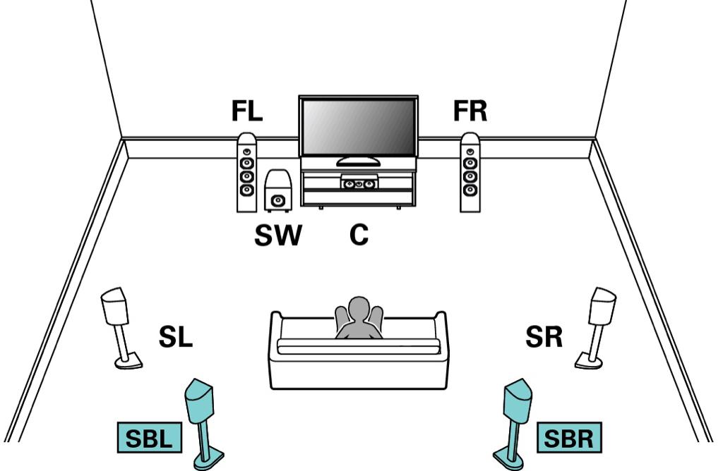

From above an Atmos system would look like this
For any room, you’ll want the couch away from the back wall for acoustic reasons and to get your surround speakers slightly behind. This is especially true if you want to use rear surrounds(7.x or 7.x.x) where you should have at least 5’ behind you.
