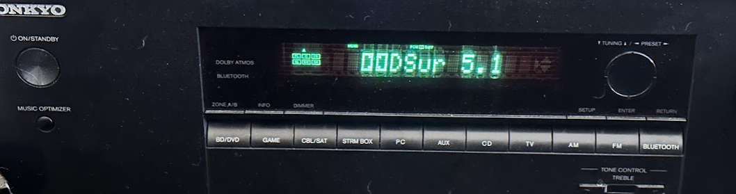

The speakers are Sony, RCA and a couple of generic ones where I can't see the brand because of where they are mounted. I do have a subwoofer and I took a picture of the setting which is the one they trip on.
Are these speakers like from HTIB (home theater in a box) type sets? Sony and RCA brands are pretty generic usually. They can be very low impedance and could be the base cause. To use a subwoofer you tell the avr there is a sub and change speaker settings from full band to one with a crossover (80hz is a good starting point). That should lessen the load a bit.

Ok, so you have it set to a 5.1 Configuration and have the Subwoofer set to Yes. Under the Crossover settings, I'd set all of the speakers to 100Hz or HIGHER and set the LFE of LPF to 120Hz. Don't know which HTIB speakers are in use here so better safe than sorry. The other thing I'd do since you are dealing with mystery speakers is something many would never do. Set the Speaker Impedance setting to 4ohm. This will limit the power output but also keep you from burning up the receiver trying to pump a bunch of power out to a bunch of mystery speakers.
I'm assuming the subwoofer in use is self powered and connected to the Onkyo's subwoofer pre out and you are not using a passive unit and are trying to power it and the front speakers from the FRONT Speaker terminals. What is the device you are using when this happens? I see you have a device connected via HDMI and it is outputting a PCM signal and the Dolby Surround mode is selected. What is the connected device and what are the current audio output settings of the device?
