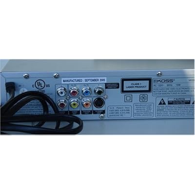

Back, and i finally got my DVD player. Its a Koss ks4110.
Pretty much says it all, but this is a good link for it.
http://www.amazon.com/Koss-KS4110-Progressive-Digital-Compatible/dp/B000JI7830
PS, im not going to buy a new DVD player, idc how crappy this one is.

  1. Your DVD player does have a digital audio output. It's a coax audio output and is the orange jack on the back that says "Digital Out" (at least, I think it says that).
