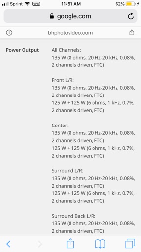

Onkyo 818 power question and why no atmos ?

Is it 135 watts 7 ch all at once ?

It looks to be 135w two channels driven. Dont see any numbers for all channels driven or the capability of the powersupply.
The 818 pre-dates Atmos in avrs....did you buy it at the time of release or later? No, the specs say the 135 wpc is 2ch driven, not all seven, not that that matters much anyways in real use. I'd not pull the specs from a retailer's site but rather the manual, too. The 6 ohm ratings looked odd, they disagree with the manual, think bhphoto got that part wrong.

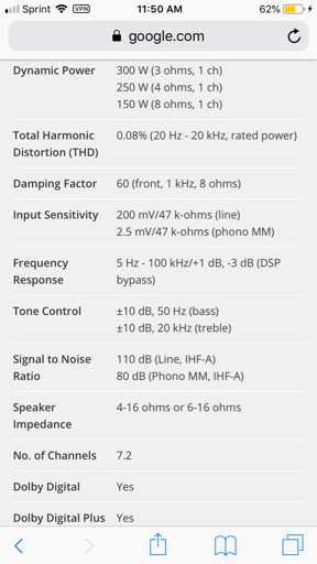

bought it new ? Does that mean it’s not high power when running 7ch?
With a power amplifier it could run 9 ch but with no atmos because it’s older .
Are avr weak wattage wise going 5-9 ch??

One year newer model TX-NR828 measurements should be very close to 818.
(0,1% THD - 1kHz)
2 Channels Continuously Driven, 8 ohm loads 147 watts
2 Channels Continuously Driven, 4 ohm loads 204.4 watts
5 Channels Continuously Driven, 8 ohm loads 109.9 watts
7 Channels Continuously Driven, 8 ohm loads 78.5 watts
https://www.soundandvision.com/content/onkyo-tx-nr828-av-receiver-test-bench
Sounds like a pretty powerful mid level avr .

The question about new was whether Atmos was generally available at time of purchase....but you should know what features an avr has or doesn't have if you buy it.
It's a relatively high power avr, altho there are some with more. ACD ratings aren't all that meaningful, as the demand on each channel simultaneously is generally not going to happen in real use.
You have pre-outs on the 818 so you can always add more powerful external power amps....more powerful than amp sections of avrs at least.
