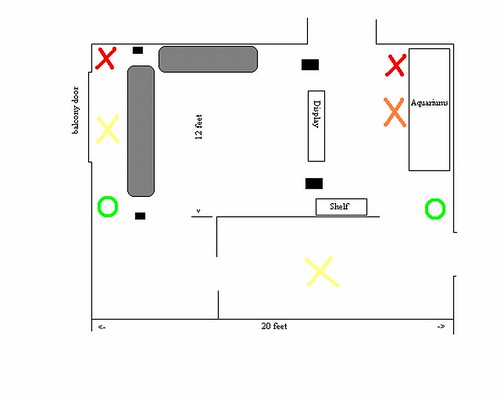

After some thinking, some wandering about in my room listening to the thump thump of a kickdrum, and some additional reading, I am beginning to appreciate the complexity of sound reflections and room treatments.
I happened to put on Clapton unplugged while doing some cleaning up and noticed a difference in the boost to the kickdrum as I moved around the room. The regular repeated thump of the kickdrum made for a nice way of checking out room accoustics while listening to good tunes. :D
In the image below I have marked out the areas where I noticed bass boost where:
Red = most -> orange -> yellow -> green = none
I didnt check out the corners in the dining area or by the door, though it would be interesting to see what I found there.
The most surprising one to me was the noticable boost in the kitchen area. I am not sure how this applies to the placement of traps yet, but I did find it interesting. Clearly an irregular shaped room offers additional challenges and large glass doors do pass bass, but not all bass.

If at all possible I'd put a trap in the top left corner at that red "X." I'm just now finishing up doing pretty extensive acoustic modifications to my listening room and the improvement in sound is significant. The base nulls are all greatly reduced and everything is clearer.
The room has a drop ceiling so I stuffed Ultra Touch cotton insulation all around the perimeter or the ceiling, extending about three feet in from the corners. I also have some Real Traps Mini and Mondo traps and three of the triangular corner traps. The big base nulls in the center of the room, where the seating is, are still there but nearly so big. You can learn a lot by listening, but I've found the Radio Shack digital meter to be a big help. I also got some software for my laptop that generates tones of any frequency. The music you may be listening to at any one time won't have every frequency, so using the software is much more efficient. It was a free download and there are many options on the web.

Thanks for the reply Peter. Given my room shape and furniture arrangements, its was originally suggested I put traps at the wall/ceiling interface at the front and back of the room.
After my walkabout, I wonder if putting something in the corners where the red Xs are (can't go full ceiling to floor) might have a significant effect.
I have the RS meter, REW and associated cabling already, just havn't taken the time to do any measurements yet.
I have lots of work to do on this yet.
It's made a big improvement in my room. Of course, my listening room has two functions; watching movies and listening to music. What the room looks like is irrelevant.

Its not so much looks (though my room is no beauty) as practicality. The aquarium stand has 80 gallons of water in two tanks that I do not want to make the effort to move just now, so I have to work around it.

Nice! Since I need to put the traps in the top 3' of the two worst corners I need the 'spiderweb-in-the-corner' version. ;)
