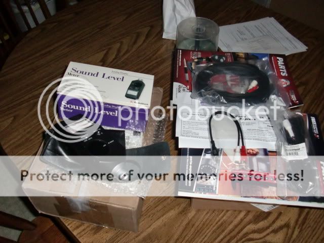

Scott Simonian from AVS sent me his mic and ordered me some cables from Parts Express.

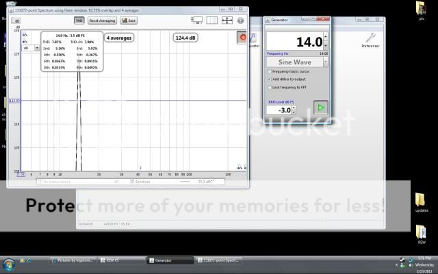

I ran an SPL test at 14Hz and 18Hz so far, it may be a day or two before I get a good FR responce curve measurement.

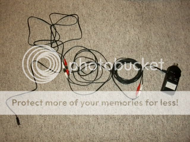

The mic and cables from Scott:

You'll want to aim the mic straight up. You can provide sound output to your receiver via hdmi, however the cables are to hook up your mic to your PC's sound card input.

so I connect the mic RCA out to the Y splitter, to the 25' RCAs, to the other Y splitter with the jack, to Line In on PC?

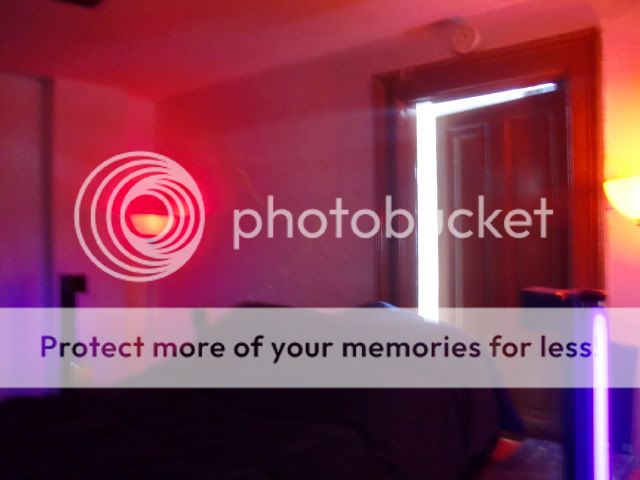

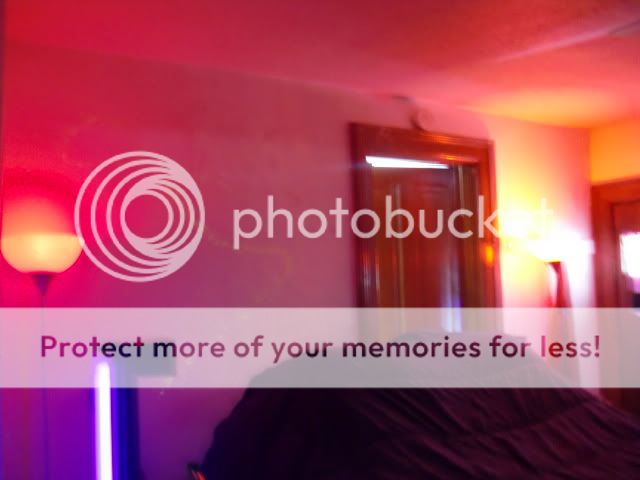

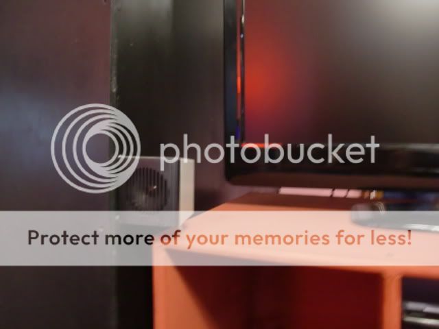

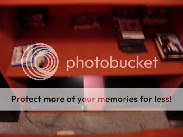

They're fuzzy, but should give enough info on things such as a perspective on the entry way, how far the bedroom door usually is open, the plaster that is coming off the lathe (admittedly on it's own, not from 135dB of 14Hz) the structure of the bed platform, space between and above towers.
My girlfriend and her son finished moving in the rest of their things, some things strewn about. Not quite the same bachelor pad it was, for the better I hope.

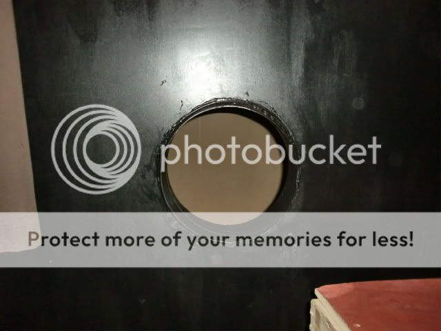

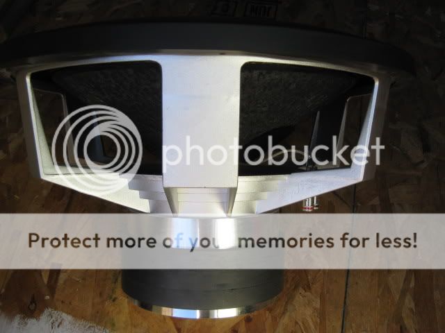

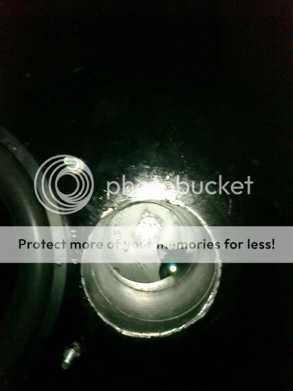

Can't tell, is that an IB setup since you're using the Fi drivers?
dem beats

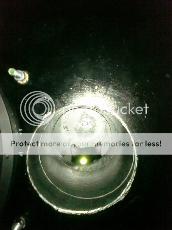

5th pics from the bottom shows the port.

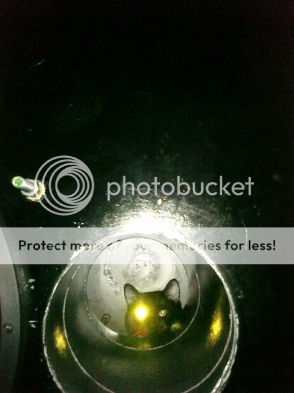

If I had that rig, my skinny cat would climb right in there....
K
kryptonitewhite
Audioholic Intern

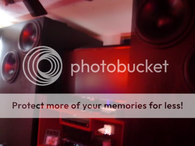

My old cat used to crawl in there during pure sine waves at tuning! Crazy cat is gone now :( It is sort of a ported infinite baffle, or a giant SSLT...some of the things it has been cloned. Each tower i 128 cubic feet, one 12" diameter port 5" long for around a 13Hz tuning. Two fi IB3 18's per tower, twom EP4000's, one per tower/pair of 18's. No EQing yet, no HP filter.
This is a copy/paste I did on a few forums so pardon me for being overly errogant ( not so nice forums :) )

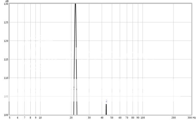

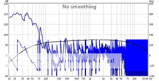

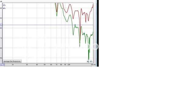

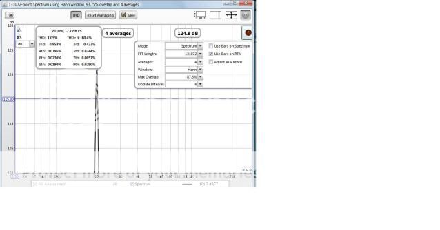

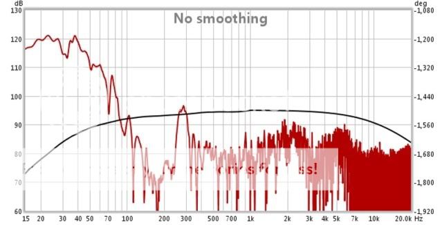

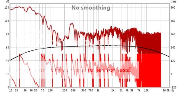

5dB increments to see compression starting at -40dB ending at -10dB master volume. Yup, thats a 130dB peak :D Yup, thats solider than solid a 10Hz, yup, look at that 6Hz ;)
15Hz on up
DC on up ;) ;)
GranteedEV
GranteedEV

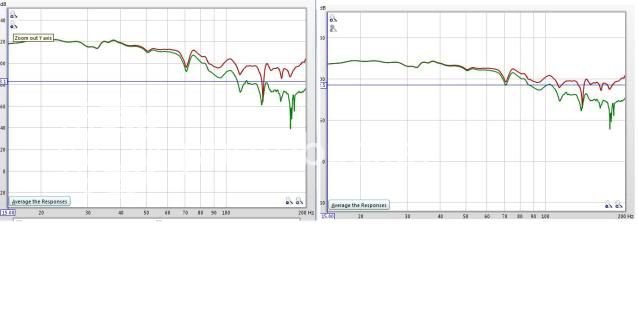

Impressive, though you're a good 12db down by 80hz.
Based on the pics, your mains look lacking, though.

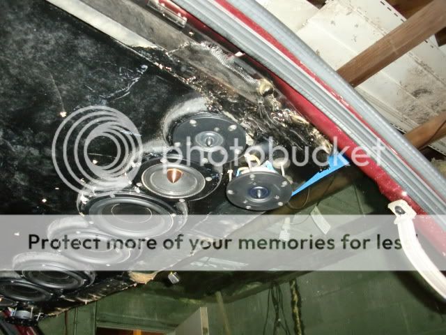

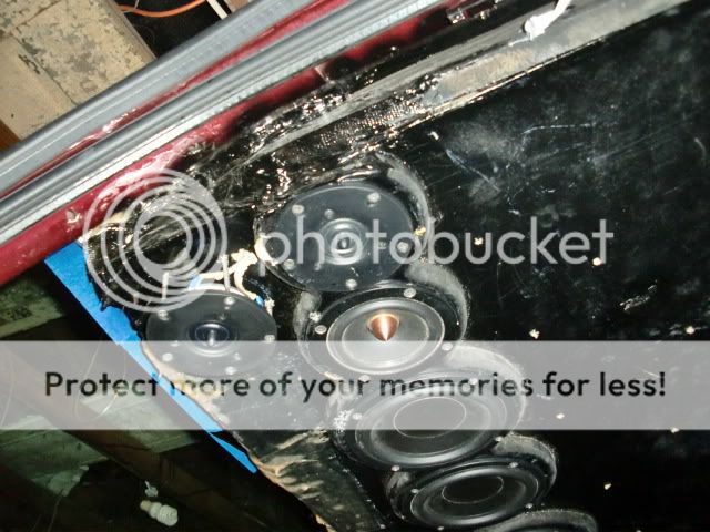

the new subs going in my van wall, four Fi reconed Blueprint Audio 1803s

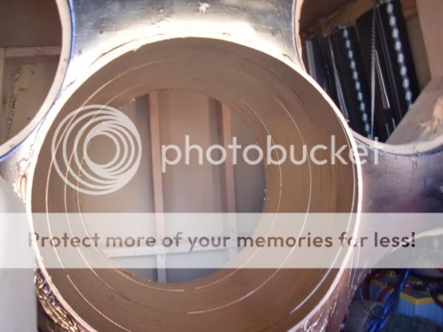

reworking the wall and new port, 20" port 24" long 45 cubic feet 23Hz tuning, those are two Audiopipe AP30001Ds you can see through the top right subwoofer cutout, theres two more on the other side, 1 30001D per Fi 18
the extremis sitting out while I modded the sealed enclosures in the van

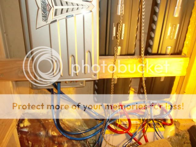

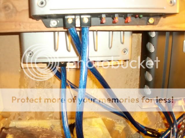

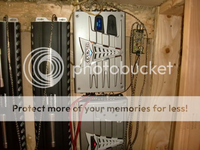

2 APs on the left, SX500.2 up top, and KX650.4 below
other side, 2 APs and 2 KX850.4s
really messy, not cleaned up yet
still very messy, been cleaned up some since then

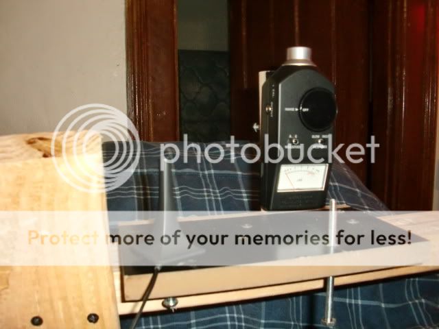

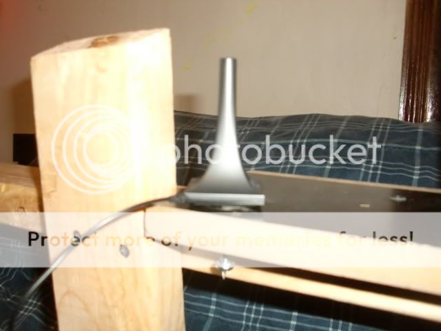

My neice Payson said I am full of it, those numbers can NOT be right even if it is 80%THD... so she made me get a better mounting screw so we have no vibration issues when you guys tell me how to run Audyssey later :)
we're multitasking today :)

Here is my old cat that passed, pic is over a year ago, he had a bad eye so pics made it shiny LMAO
inside the port
CATCHOW!

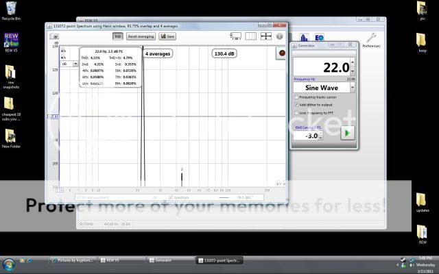

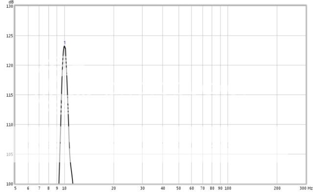

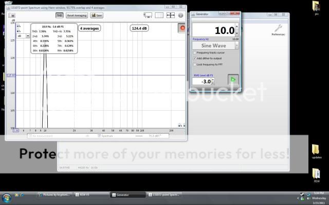

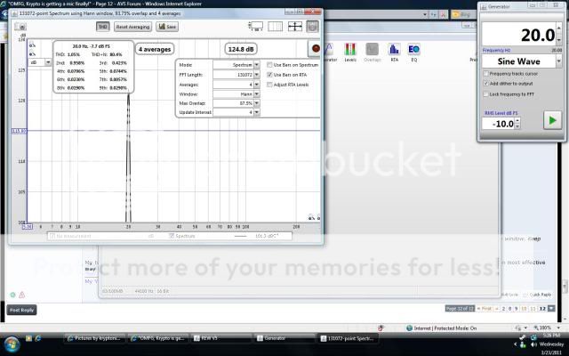

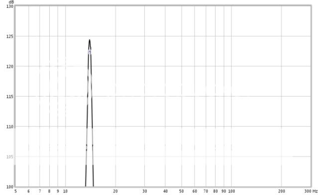

10Hz -3.6dB FS
THD: 7.70% THD+N: 7.75%
2nd: 5.74% 3rd: 5.11%
4th: .339% 5th:.363
6th: .228 7th: .129
8th: .032 9th: .0258
124.4dB

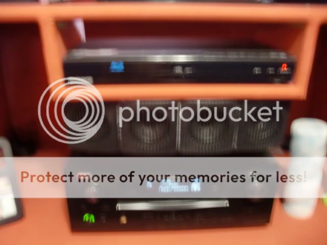

Sounds Good

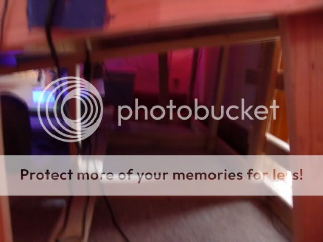

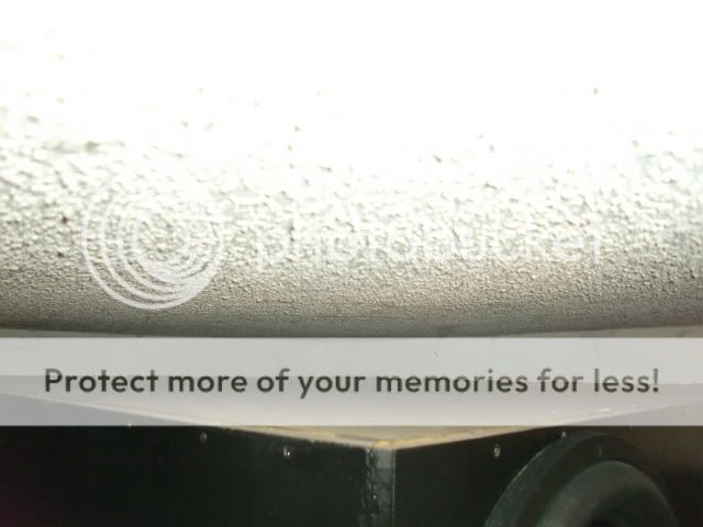

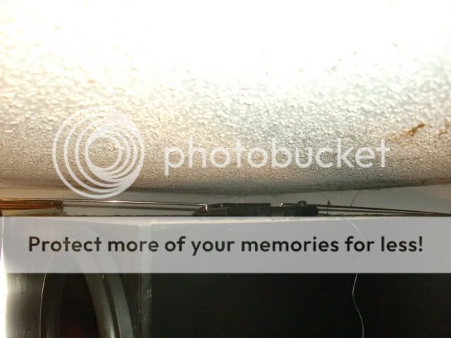

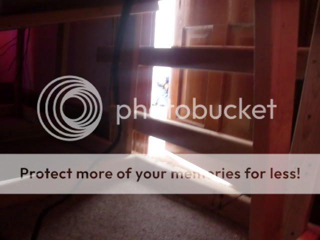

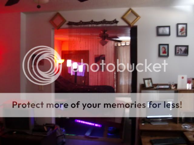

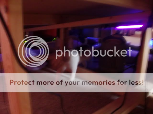

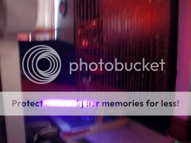

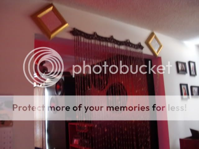

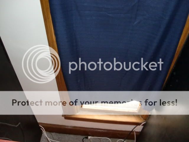

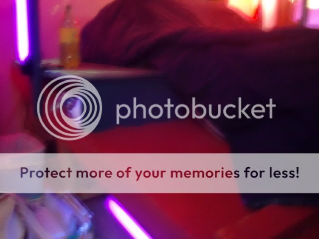

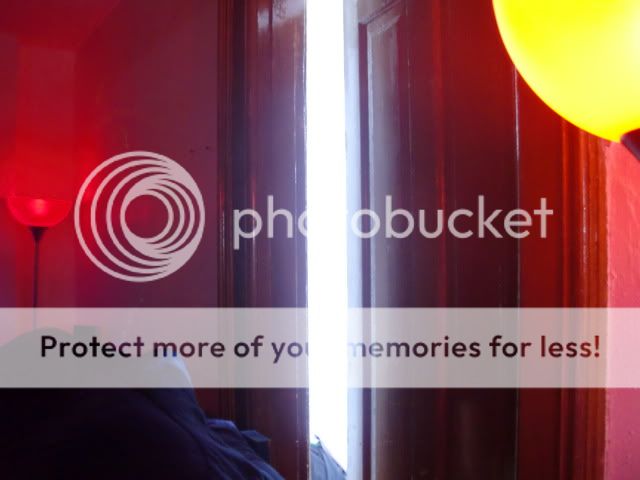

the photos are kinda fuzzy.. but WTF is this... :eek: how does that ceiling fan stay up... lol
seams like a pretty small room for all that HUGE gear...
and what is the wood scaffolding for?
explain explain explain... oh and open the drapes and take some more photos...
K
kryptonitewhite
Audioholic Intern
lol I am a terrible photographer, I havent for the life of me been able to make this camera take clear pics. That ceiling fan did rip down once already and it is starting to again. I'll be building a square frame and running 4 supports from the bleechers/bed to the ceiling :p
That window behind the TV is boarded up :-O
