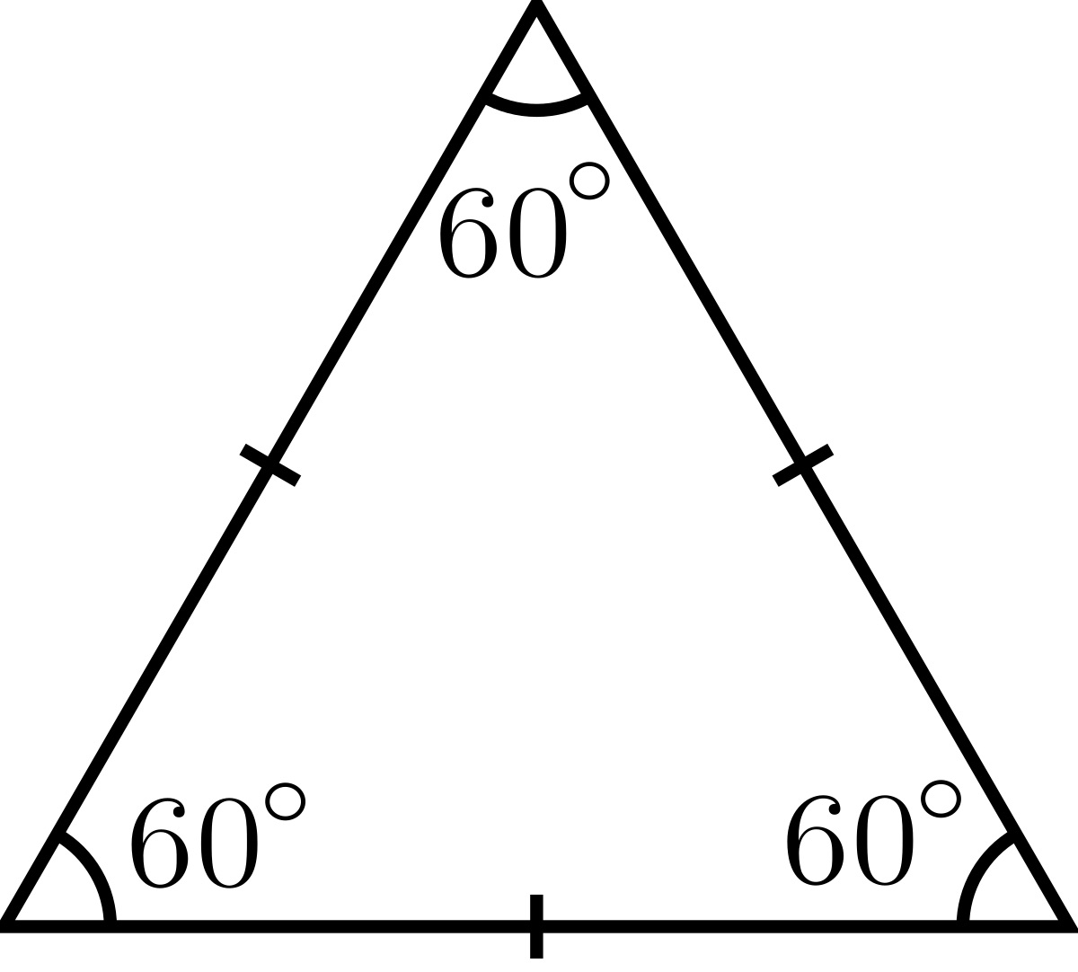

Helps to use a equal lateral triangle as a good stating point where the point of the triangle peak is about 1 foot behind your head.
In geometry, an equilateral triangle is a triangle in which all three sides are equal. In the familiar Euclidean geometry, an equilateral triangle is also equiangular; that is, all three internal angles are also congruent to each other and are each 60°.
