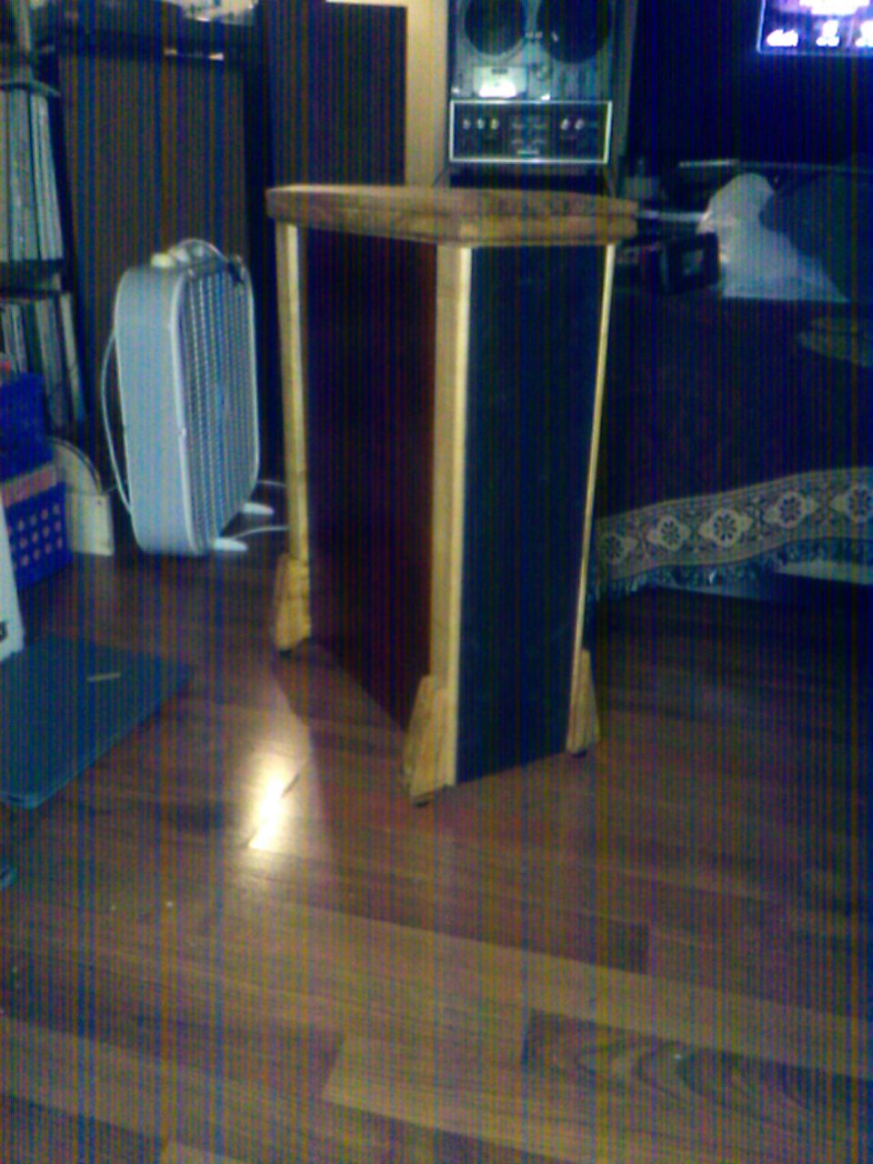

my latest project was a set of 4 speakers, labyrinth, back loaded, using 8 speakers taken from mid 60's akai tape decks, 5x7 oval paper with alnico magnets, probably, a buck each back
in the day. i sat down and laid out a design for a back loaded labyrinth with an 82" line. put two speaker in parallel, one on top of the other, ending in a 4" round port, poly filled, double layer side walls or 1/4" plywood, bonded with non hardening adhesive. i built one such unit, brought it in and tested it.... sounded pretty good, but was missing under about 200hz.... i then learned i had over stuffed the thing with polyfil and reduced the packing to a light fill, brought back and got it down to 100 hz. (as low as my puter can put out on the sound card), put it back in place of one of the jbl speakers to get a feel and i thought hmmmm pretty good indeed.
so i built another, and tested the pair, sound was very encouraging, so i built the other two, and then set about altering the fill in each to retest and see which came out on top, it worked out to be the second iteration of the first speaker cab, so i did them all the same, finished the glue up and put the four together, two in series to get 8 ohms per side and fired up dark side of the moon.
to say that i am happy with the result is an understatement, i would be proud to enter them in a diy contest, i don't think i would rank at the top, but my bet is i wouldn't be at the bottom either
the design visually is my take on japanese architectural design. and i used a silver maple that i had sawn up about 5 years ago, for the top and trim work, nice tiger stripe

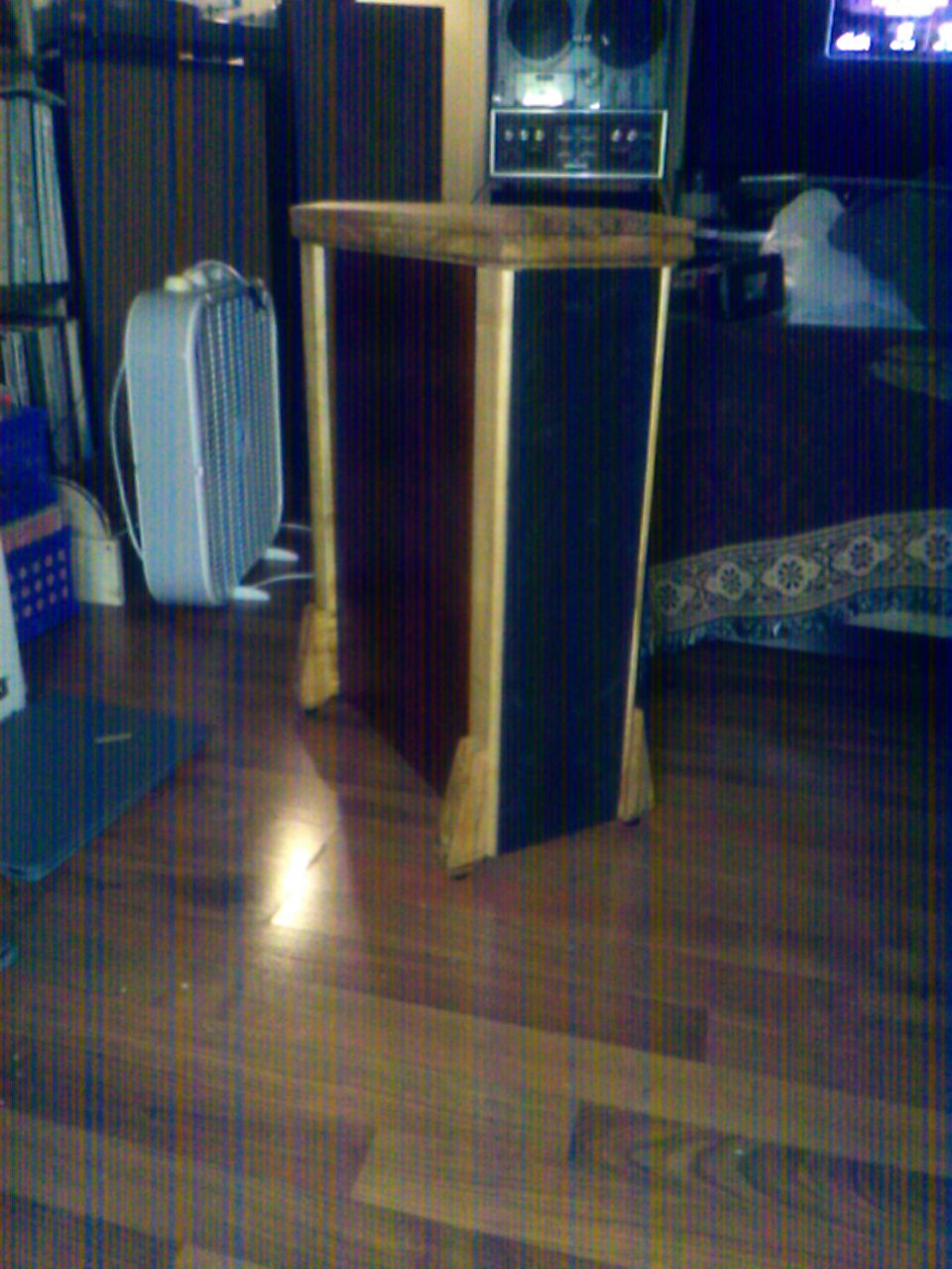

bob gView attachment 34864

try as i might i have never seen anything written on the reuse of of vintage drivers in new designs, this might be because of several issues, not the least of which is unknown parameters and/or the lack of equipment and ability to determine them.
my use of the likely very cheap 5x7 akai speakers was not because i couldn't afford better, or don't have better to work with, rather it was simply an exercise of experiment to try to apply what i have spent a number of years reading about.
my personal technical library is probably within the upper 1% and i am constantly on the lookout for more on a variety of subjects.
as for hot meals? i do 99% of the cooking around here, and have for decades, i don't miss many meals. :)
my hope is to find a group of folks that are into learning from doing, working with repurposed drivers, in interesting designs, even if a small one. i thought maybe there might be a few here with similar interests, as the question has been brought up more than once on this forum.
enough of all that...
my next project, the reuse of 4 sansui 12" woofers, that i replaced the petrified cloth surrounds with foam on, i am thinking two per cabinet, in a MTM configuration, using two 3" full range to cover the upper end, driven by biamp via SET tube. back and front loaded.

for the current units, they need no crossover, running full range
the base is not big, but it is there, is tight and i can hear individual notes, no single boom tone
the mid range is in my mind about perfect,
the high's have enough air, and as stated earlier, i can't hear over about 9.5khz anymore anyway
for the next project, a crossover will be needed, and i want to keep it simple if possible, with a first order
the 12" sansui's go up much further than i would have ever thought, well over 5khz but i see no need to go that high, the tweets are faital 3" and have a reportedly pretty flat response from around 200 up to way over my hearing
i have the equipment and wire, formers etc to wind my own coils, so plan on some work to get something that works for me.... again if i like it and see the need, maybe then i will invest in some test gear. until then "kiss" is the rule around here.
