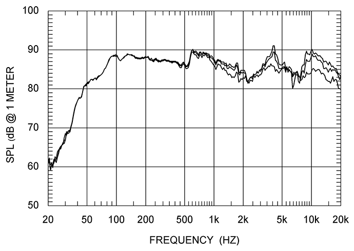

Impedance curve.
Frequency response
Those are NRC measurements. Not very good.
Those speakers are not very suitable for a large space.

Thanks for the model clarification. Here's a review with a good suite of measurements: http://i.nextmedia.com.au/Assets/bw_685_s2_loudspeakers_review_test_lores.pdf
