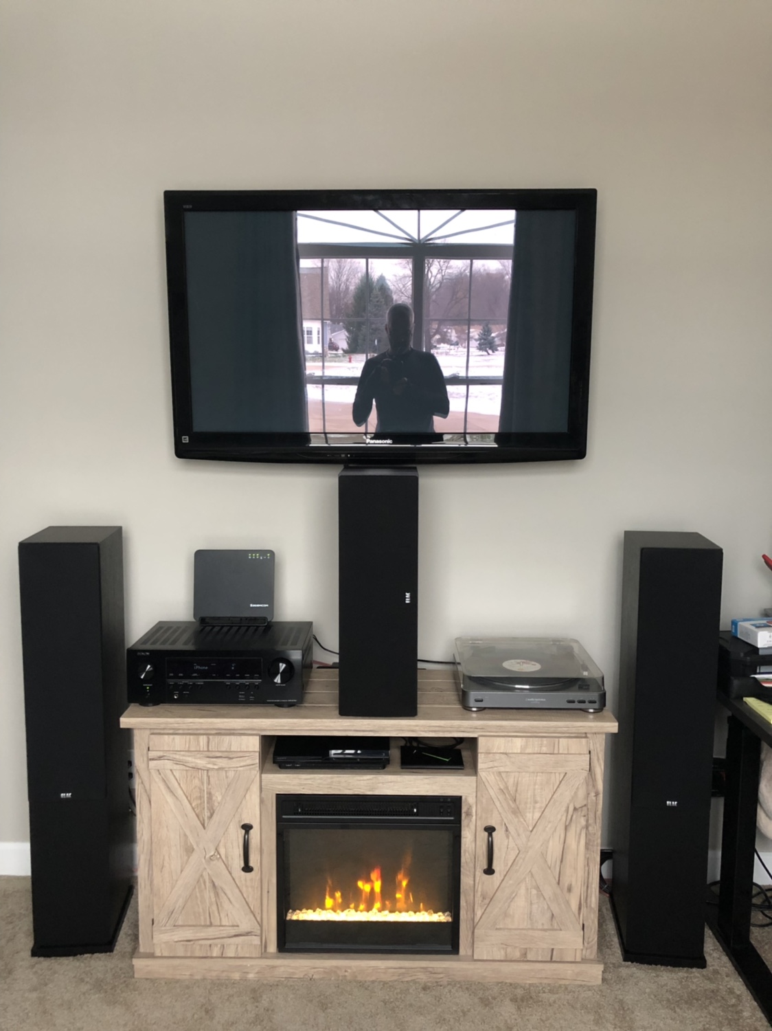

I have a 13x11 office that I work from home and use for listening to records. Also have a Panasonic 46” plasma 720p and still love the picture as long as I draw thick curtains in front of that big window (nice sound deadening!) As usual Black Friday allowed me some upgrades. I got a great deal on Elac Debut 2.0 6.5” floorstanding speakers, NVidia Shield TV, Echo Dot 3rd gen, and Denon AVRS740 which I’m running the Elacs at 6ohms. They sound amazing and I ran a few Dolby/Atmos demos knowing it wasn’t the correct setup, but to see what it had and what it was lacking. I think I could get away without a Center channel due to only 4 feet being between the speakers. I don’t feel I need a sub for now. These speakers sound amazing and are a different animal compared to my Polk Signature series. These seem very bright. The viewing area is 7 feet from the speakers and 8 feet from the screen.

Room pics

Nice setup. Run your avr at the 8ohm setting as all your doing is limiting the amps. Also it maybe hard with the desk, but I'd try the move the towers further apart if possible.
Thank you, that was something I was trying to figure out, I’ll set it at 8 ohms. I can move my desk over another 2 inches and move the left speaker another foot towards the door. Will that work? I imagine I’ll just have to rerun Audyssey.
Any little will help. You want to try to achieve an equilateral triangle between them and your main seat.
I was able to move the speakers another 2” apart on each side.
I decided on going with the center channel, being timbre matched and an important speaker. Also going to have to stand the center channel vertical which shouldn’t be a bad thing. It will be about 4” off center laying it flat. I’ve read that vertical or using the same speaker as your left or right can perform better than horizontal center channels. We shall see. This puppy is 23.5”L x 7.5” H x 10.5” W.
