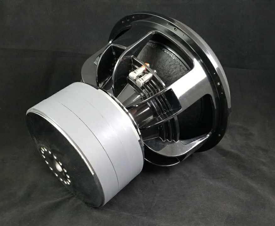

Stereo Integrity has the HST-15s as well, but those will weigh an absolute ton and you will need to build support braces just for the motor, so I would do your back a favor and skip the HSTs.
Good lord Shady, that thing is a beast!!
You'd need a hydraulic floor jack just to get it into the box!

Okay, okay... maybe I got a teensy bit excited when I saw that huge motor, almost bigger than the cone and basket assembly, and a cone with a surround on it that looks like it could double for a tire in a pinch. Maybe...
