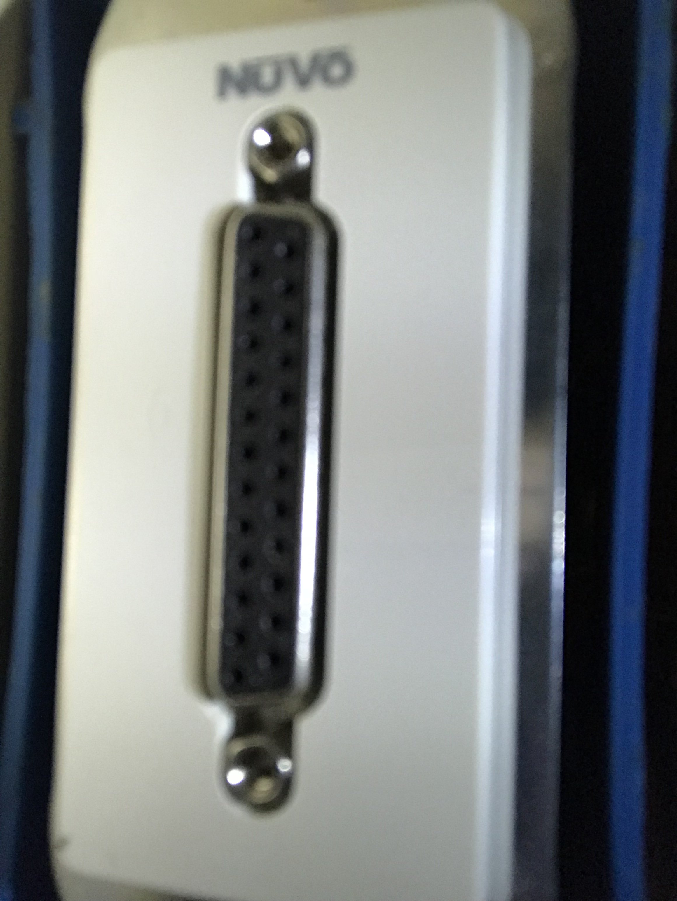

Good morning! Our new(ish) house is set up for the Nuvo Simplese ... except for the receiver itself. If I buy a P3100, could I install it into the existing Nuvo 25-pin port? Thank you for any help you can provide!

All indications are - no. The newer Nuvo stuff appears to be 100% network based, while their older gear was on NuvoNet and used that 25 pin serial breakout cable constantly. The 3500 is a 3 zone player with internal amplification and support for their network based keypads. It does not show anywhere in the manual support for the 25-pin serial connection.

Thank you for your reply! re: our current setup, I’m seeing speakers in the ceilings of three rooms, three controls on the walls, and the 25-pin connection pictured above. That’s it. I was hoping there’s a possibility that I could buy something compatible and install it myself. Again, thank you for sharing your expertise in this area where I’m clearly lacking it!

You will want to go to the wall controls and find out what model they are. You may have to remove one from the wall. I'm not 100% sure, but I believe that the wall plate with the 25 pin connection is their proprietary setup that is designed specifically to work with a controller unit. It's COMPLETELY insane that you would move into a new place and they would have deinstalled that piece as it is required to make all the wall plates work. You can't use the controller without the wall controls and you can't use the wall controls without the controller. I would never sell my home and take a piece required for core functionality.

Nuvo units are on eBay. They aren't as slick as what you linked to, but I'm thinking that what you have won't work with anything but a legacy product. It is possible that they wired all the keypads with network cabling and that your speakers are run to the same location. In which case, it may be possible to dump the old equipment and upgrade everything to the new gear.

If I were you, I would pull the wall unit, find out the compatibility with legacy Nuvo gear, maybe give them a call, then get a replacement unit that is compatible from eBay or perhaps even new. They have software you can use right on their website, but it will take some work to get it all going and there will likely NOT be any phone/mobile control possible. As common as it is these days, 5-10 years ago, most homes didn't have any mobile control and the products made didn't offer it. Now it's common, but legacy products don't support it. Nuvo for sure has this headache on older stuff. I'm looking to lay a simple Crestron system in to run a an older Nuvo system from someone's phone. It's an Essentia system from them. I'll let you know how it goes.
