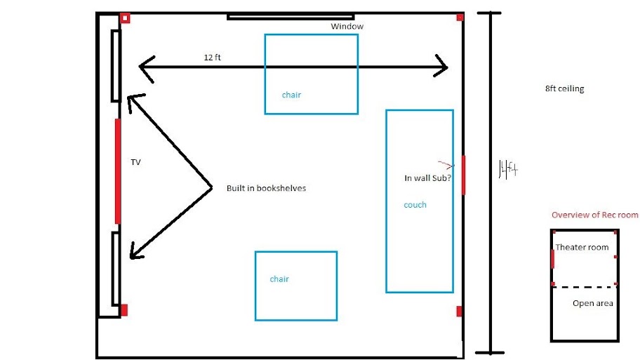

I am about to finish my basement and want to put in (or at least run the wire) a home theater system and 1 or 2 speaker zones. The speaker zones would be one outside (for future hot tub/deck area) and the other would be for the garage. I don't know what that looks like as far as receivers/controllers.
For the home theater room, I just want a decent surround set up. The area of the theater space will be 12x14, half of the rec room area, with an 8 ft ceiling. The way it will be setup, I could have the sub built into the west wall, immediately opposite of the TV, which is centered on the east wall. (this would be right behind a couch)
Yes it is one big room and I am using half of it as the theater room. The room is kind of naturally split there as an I-beam hangs down to 7ft4in where I made the dotted line. I would probably tuck a rear speaker where the 8 ft ceiling drops down to make a box around the I-beam.

Diagram of room

What are the zone 2 speakers? As for speaker wire, here is a table. Where are the components going? As for the sub, you might consider running multiple RG6s thru out the room for placement options. The RC series are fine for rears and distributed audio.
Haven't looked at zone 2 speakers. They will be outside probably connected to my deck. For now, my only concern with zone 2 is running the wires to the area.
Front (L&R)speakers will probably sit in the built-in book shelf. Not sure how I will mount the center yet. (Haven't completed the design below where the TV will hang)
Rears will be over the couch area. Sub will go beside the couch I'm guessing. Good call on the multiple sub wire placements.
Anyone have suggestions for smaller bookshelves? I'd really like them to be small...
