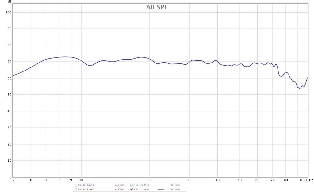

Wow Fuzz-(4) 18" subs? Holy smokes man!!!! Those graphs look very flat to me.
Yes, it took a lot to get to that point and a lot of trial and error and reading with my other setups. Unfortunately or fortunately, depending on how you look at it, my setups have gone through a lot of changes. 3 different residences, lots of gear changes from 1-5 subs and with lots of different placements and experiments. It definitely hasn't been a set up once and leave it kind of job.
So, of all the dsp's you have used which one did YOU prefer? Hope I can get the same type of response in my small room.
YOU have had a lot of experience with exactly what I am trying to learn about. Now I know who to look to when I am so lost.....LOL!!!!!

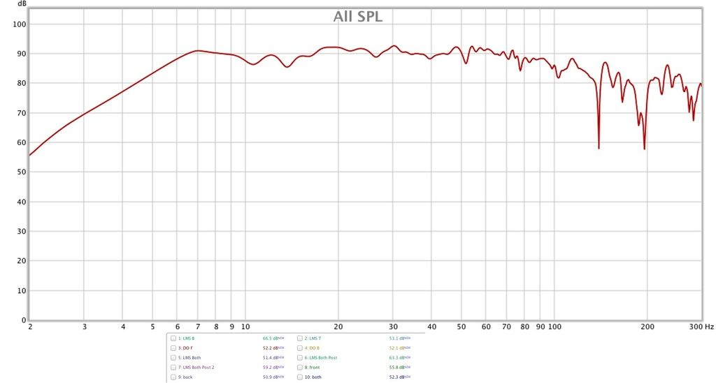

Here is another measurement from the subs, I believe this was at the last place I was living
No room treatments, mediocre placement, just good subs and EQ.
What do you mean by mediocre placement?
Not optimal. Limited options. Not where I would have liked to have placed them based on REW room sim.
