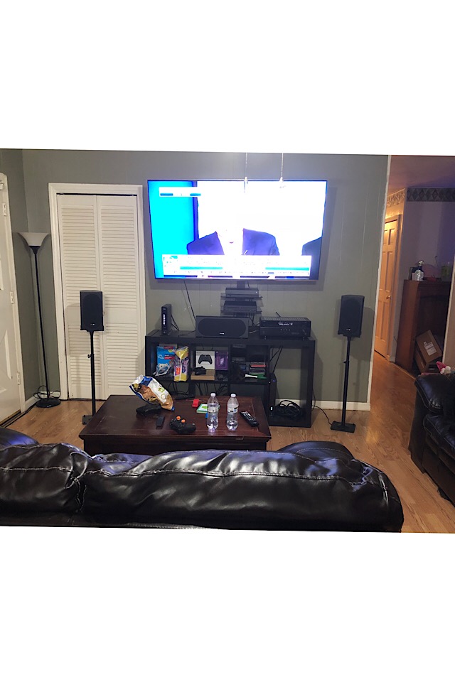

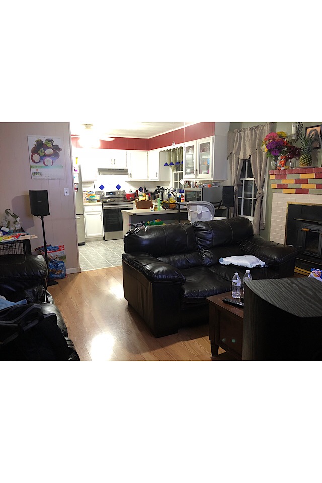

Here is pics sub is infront of the rear left.
It shakes the entire house.

I think you need to lower the height of your fronts a bit. The tweeter needs to be at the ear height/level

Thank you! What about the rears? I have the woofer on them at ear level.

For surrounds, tweeter should about 1ft ABOVE ear level.
