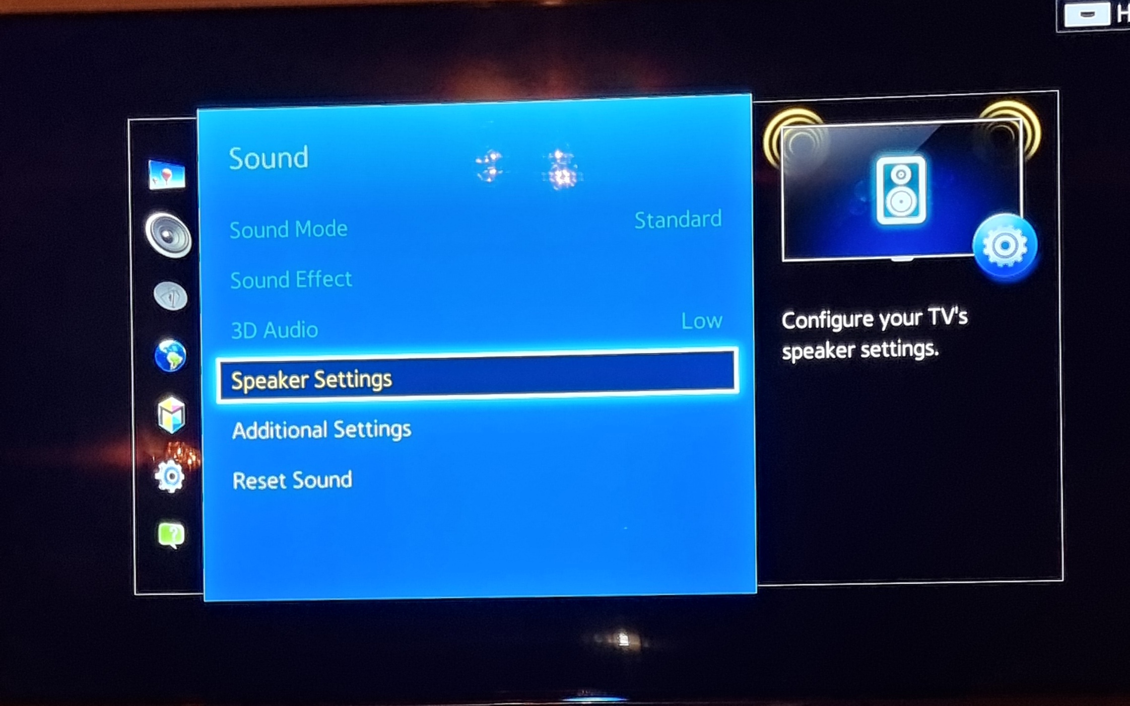

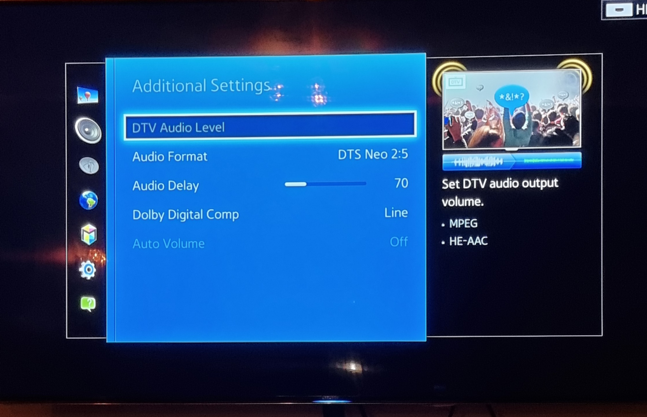

Looks like a 2014 model. On that one, you’d go to Sound > Advanced Settings > Audio Format to make changes to the audio sent out of the optical port. But, on that model, anything coming in from an external device via an HDMI may very well be converted to PCM 2.0 when output over ARC or optical. It does state that dolby audio is converted for the TV speakers and may just be converting everything no matter the output.
Had a good look into the PS5 audio settings, Yikes! I’d set it to bitstream Dolby and then play something with a dolby multichannel track and look into the Audio Format setting in the TV to see if dolby is now available as an option. If not, change the HDMI output setting in the PS5 to AV Receiver and set it for 5.1. Then, play a Dolby track and check the output settings in the TV for available Dolby Digital option. If still unavailable, leave it at DTS Neo 2:5. Again, it is converting a PCM 2.0 to a DTS 5.1 track so you will get five discreet channels and an LFE signal to the bass module.
