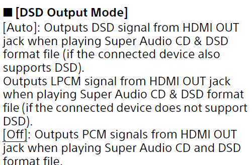

Probably not, it could be that he had the X800 set to output PCM. According to the manuals, the RX-A2060's HDMI supports SACD/DSD format. (See Yamaha RX-A3060_RX-A2060 manual page 181.
So if snake wants, he should be able to set up the X800 to output DSD, that is, turn DSD Output Mode to "On".
X800 operating instructions Page 22:
snakeeyes
Thanks!!!!
Ok I had DSD off before.
Now my Yamaha says sampling 2.8MHz and format DSD
Thanks again!!! :)
