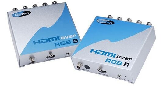

Another option, which I have never used over actual VGA cable, is a HDMI over RGB extender. RGB cabling is what is inside a VGA cable. So, while I've never tried it, if there is no good way to replace the VGA with cat-5e/6 cabling, then I might give this a try:
Those units are VERY discontinued by Gefen, and would need to be purchased via eBay.
and
I used a set of those in an installation where RGBHV cabling was run to a projector without any conduit and no cat cable. It worked well for 1080p video to his projector.
