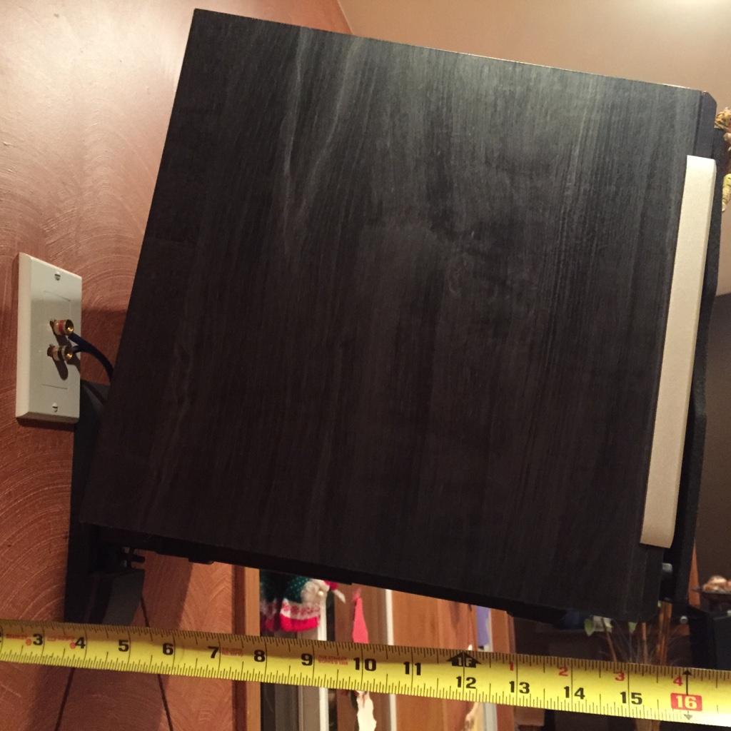

Thanks I just ordered the mounts! Got the B tech b77
The brackets on the sides can be adjusted tp fit the width of your speaker, Use some cloth between the speaker and the bracket to prevent scratches when you tighten them. You can also use double sides tape (alien tape) to grip the bottom of the speaker to the bracket it sits on. They are very secure and the instructions are very clear. Use anchors when you secure the brackets to the wall if you don't have a stud at that location. With direct radiators you mount surrounds a little behind or in front of your MLP at about 110 degrees, tweeters the same height as your front L-R speakers:

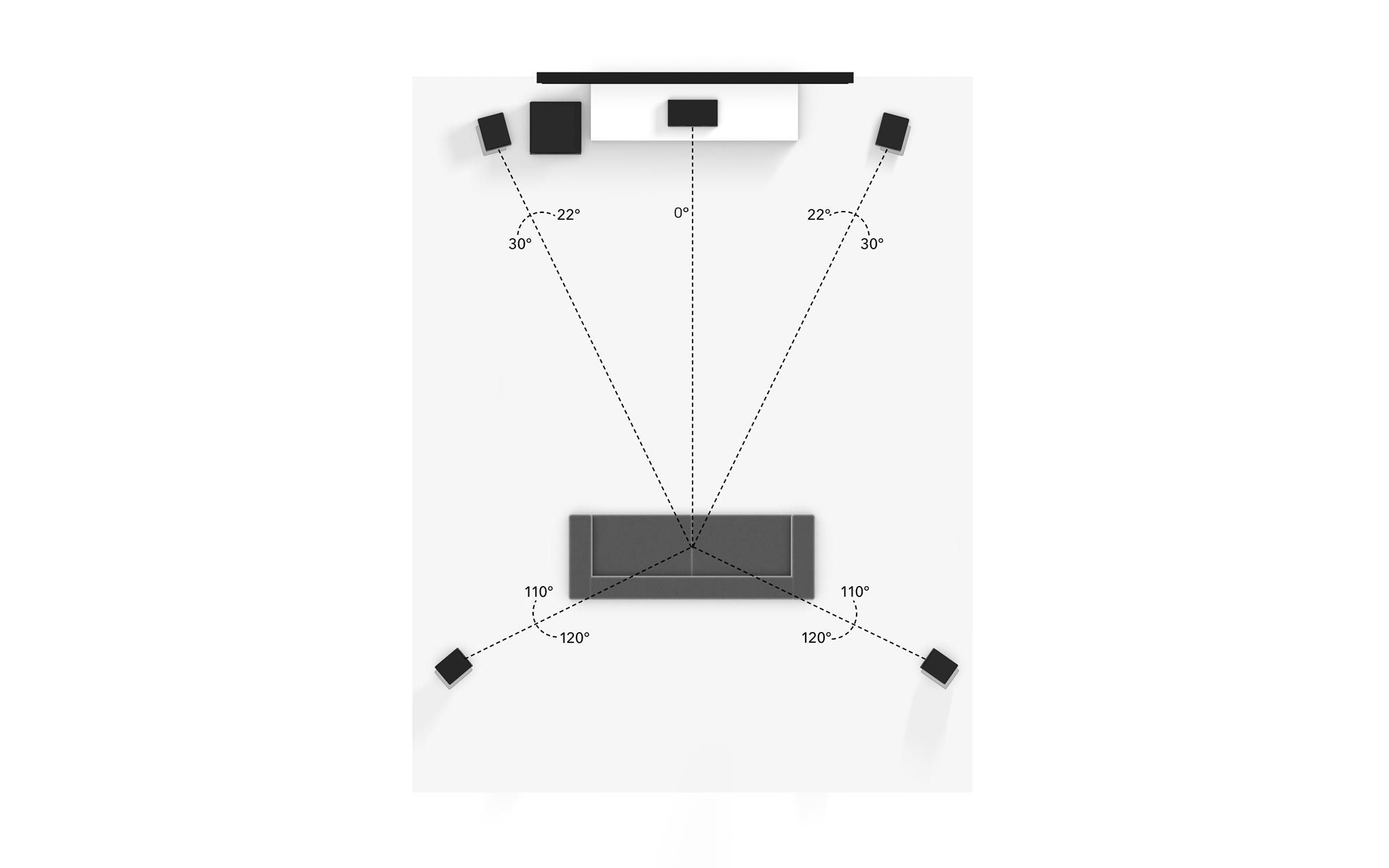

In a 5-ch bed layer, Surrounds should be 110-120º.

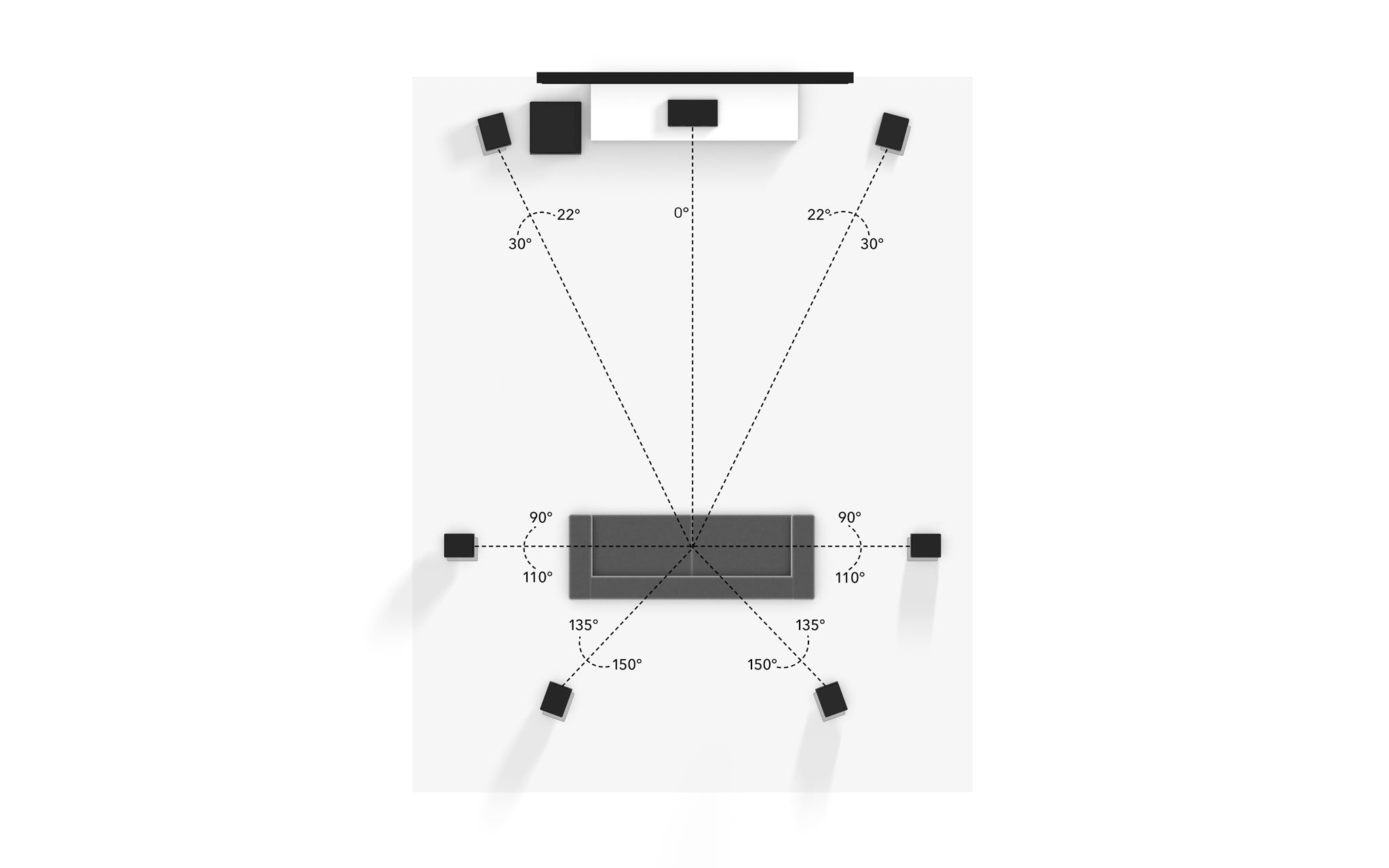

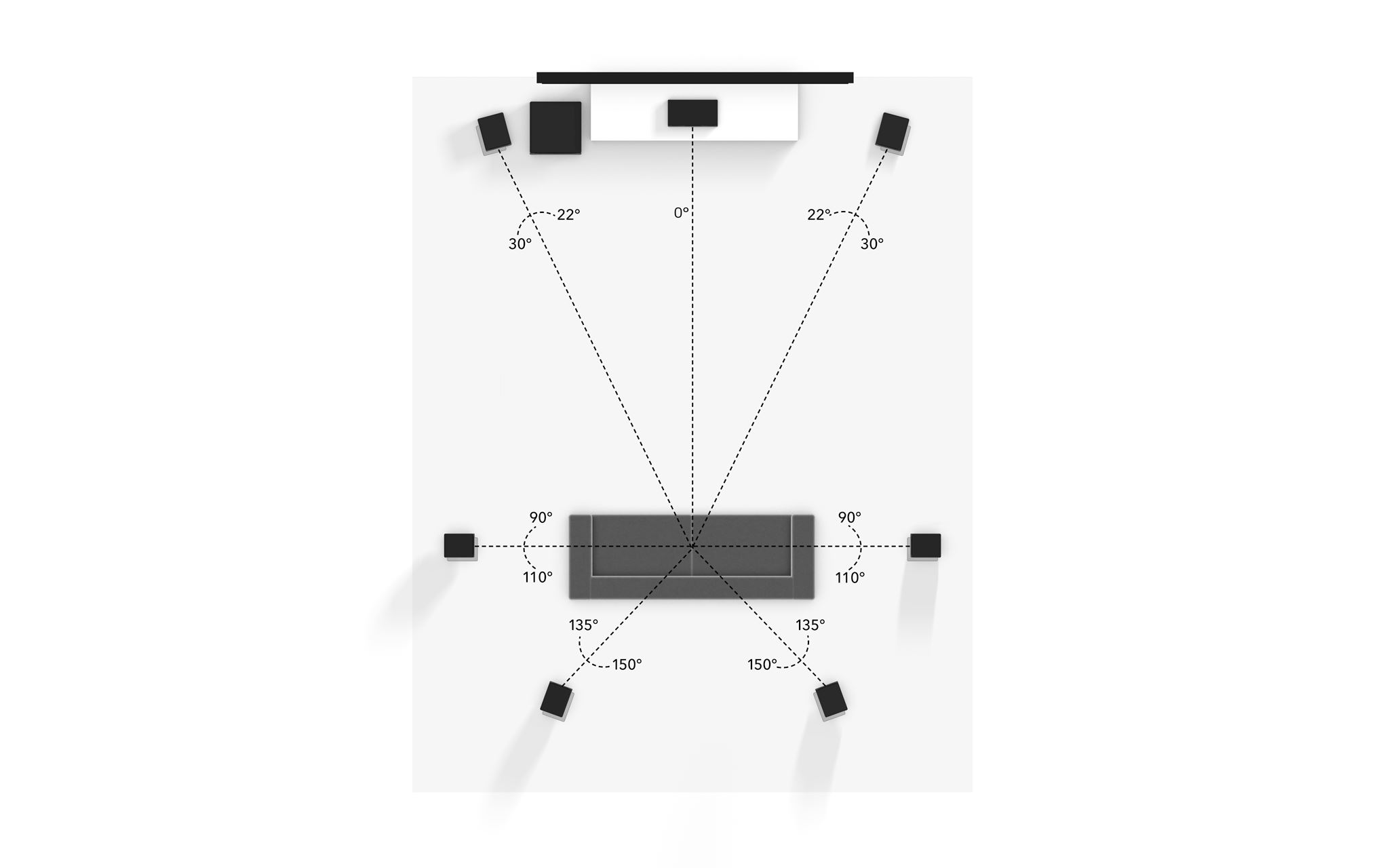

In a 7-ch bed layer, Surounds are 90-110º and Rears are 135-150º.
Height of Speakers depends on how many people might be in the "row." If you have seats with high back that can block the sound or have people surrounding you who can block the sound, it is customary to elevate the surrounds a little above head level (when seated) and aim them toward the MLP. This helps get unobstructed sound to more seats.

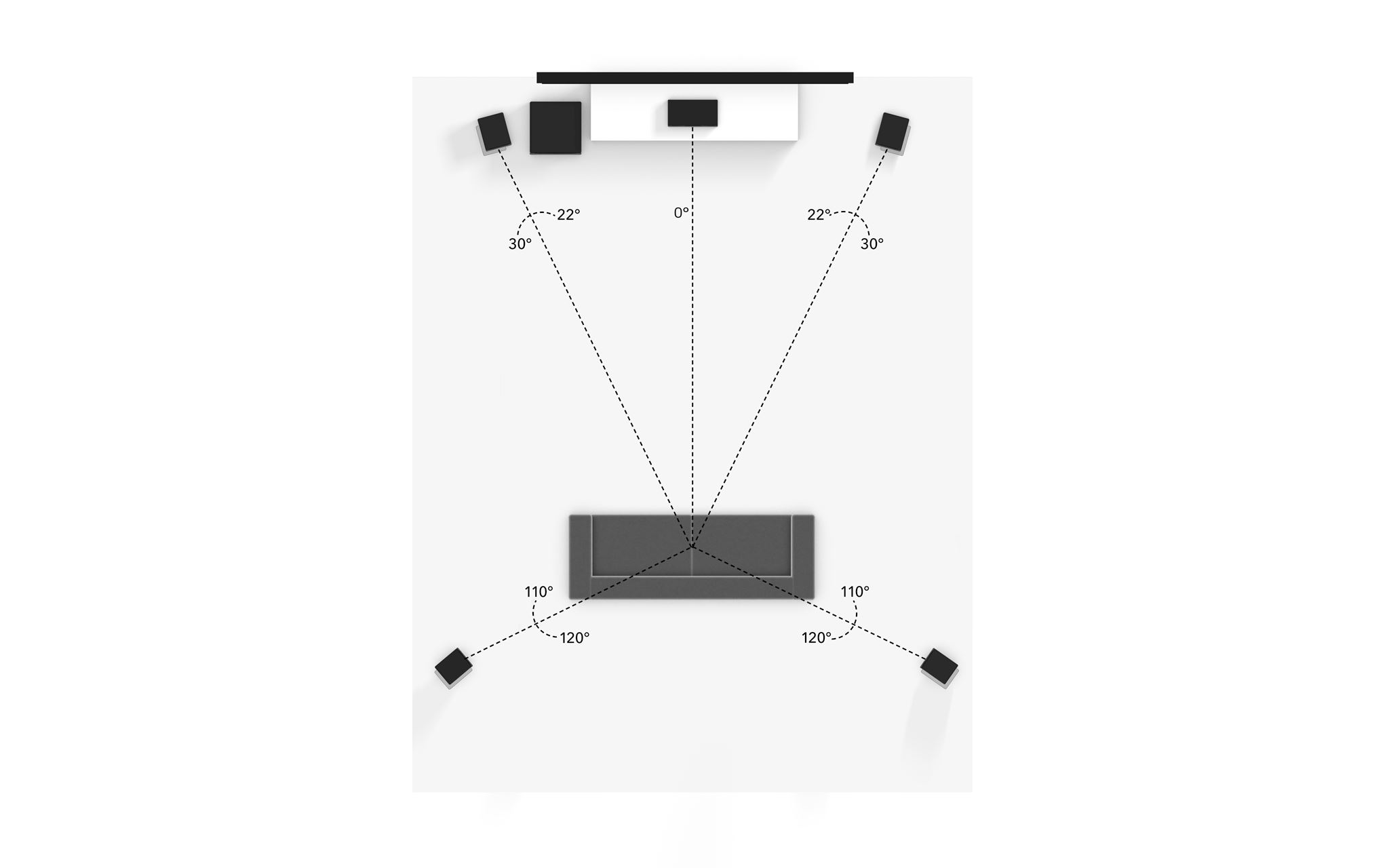

Thanks for this, I think the current placement of the surrounds are a little too high. I’d like to bring them down a little more but the current wires that run run through the wall aren’t long enough. I’m trying to find a way to lenghten the wire?
You can run your in wall wire to a switch box near the back where your speaker wire ends like this, then run another set of wires from the switch box to your speakers. You can mount the switch box right on the wall with alien tape or just a screw:

My speakers are higher on the wall than I’d like. I’d like to lower them but my in wall wire isn’t long enough. I currently have a wall plate like you showed me on that picture. But if I move the wall plate down the wall 3 feet from where they are the in wall wire won’t reach.
