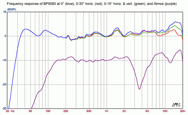

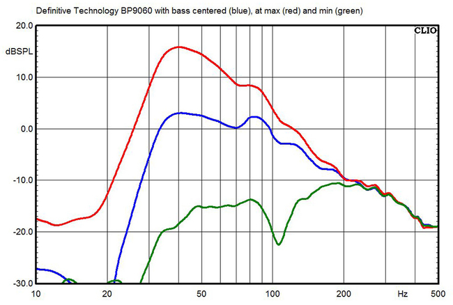

Well... calling those "sub" woofers is a little generous and I'd still want an actual sub in the mix. I'd just run them in stereo and leave LFE to your subs. Run the Audyssey setup routine in your AVR and it will set your distances and levels. It will also probably set your main speakers to "large". I'd switch that to "small", start with a crossover of 80 hz and experiment from there.
I found some measurements of your speakers to illustrate.
The top one is frequency response taken from the front and the second one shows the effect of the bass control. You can see at around 40 hz there starts a steep drop and there's practically nothing below about 30 hz. So even tho they're powered bass sections they can still use some help from a good sub or 2.
View attachment 34774View attachment 34775

I looked around but couldn’t find any, anywhere. It seems there an earlier version of the 120. I did find the low end FR rated as 29hz. IMO, horrible for an HT subwoofer. I’m not picking on your stuff btw, just sharing my honest opinion.
Your mains roll off at 40hz, and subs roll off at 30hz. You’ll have a ton of midbass, with no real weight. Some soundtracks roll off at 30hz too, but very very many don’t, and to me you’ll be missing out if you don’t upgrade subwoofage. I know. You didn’t ask about new subwoofers, but you did say all opinions and advice welcome. And that’s definitely an area that when properly addressed will absolutely elevate your whole system.
