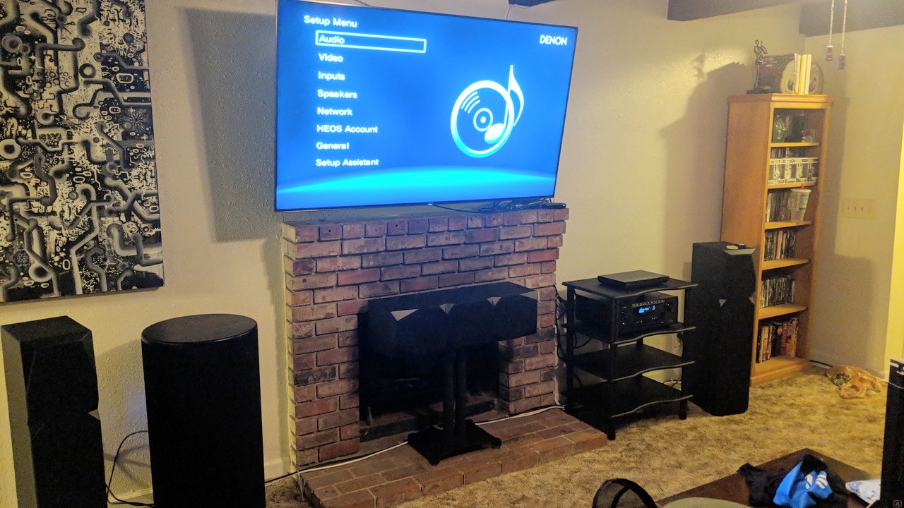

Airmotiv T1 towers and C2 center. PC 2000 pictured and my VTF3 MK4 behind the couch, set about 2 1/2ft of the back wall. Paradigm Mini Monitor v7 about half a foot of the back toe'd towards LP, and Prime Satellites on the mounted 2ft in front of the LP on the sides of the open beams protruding very slightly from the bottom. Tried to stay true to the Dolby diagram.
I'm thrilled with the 2.2 music performance. I don't think the AMT'S on the Airmotivs sound as good as the ML Motion 60's, but great at less than $800 for the LCR.
I'll take a pic when I can, similar to what I originally posted, for comparison;)
