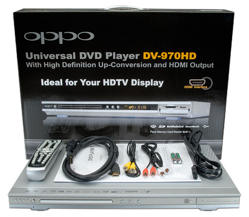

Also whats you opinion the DVD players (onyko vs. oppo), and is there any DVD players that have a VCR and UPCONVERT the dvds to 1080i.
or should i just get the dvd and vcr players separate, if so whats a good vcr?

Either should be fine. Note the Oppo comes with an HDMI cable, so if you get that one you will only need to buy one regular HDMI cable and a HDMI-DVI cable. A friend of mine is a die hard Onkyo fanatic and may be getting an Onkyo Upconverting player soon, even though I advised against it.:D Not because I think that Onkyo makes bad players, only because HD formats will eventually have numerous movies and players that are cheaper and buying a DVD player now if you already have a decent one seems silly to me. I have seen Upconverting players in action, they don't do much for me. DVD is usually not going to look bounds better on HDTV than it already does.

DVD Player
I have the Oppo DV-970HD and recommend it. I have been using it for a few months for DVD viewing on my 32" LCD. I haven't used it for DVD-A or SACD playback, yet, but the memory card slots on the front are convenient for viewing pics from the camera.
You can read detailed reviews on the secrets of HT DVD benchmark, but it is a great upscaling DVD player for the money.
avaserfi
avaserfi
Ive read that if you aren't using the HDMI cable on the oppo its not even worth having since it doesn't up convert through the components, is that right?
