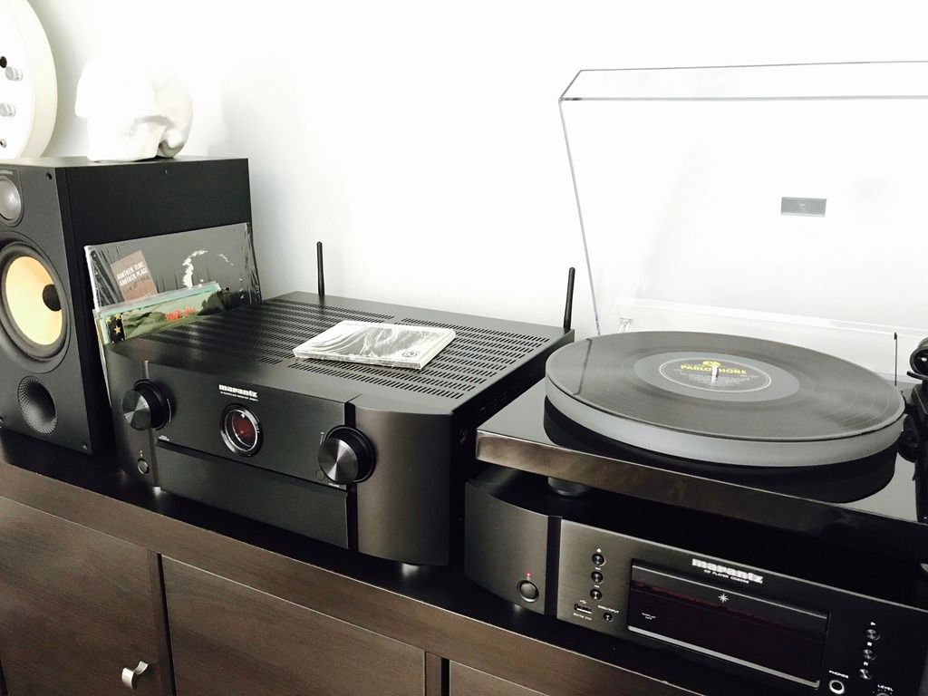

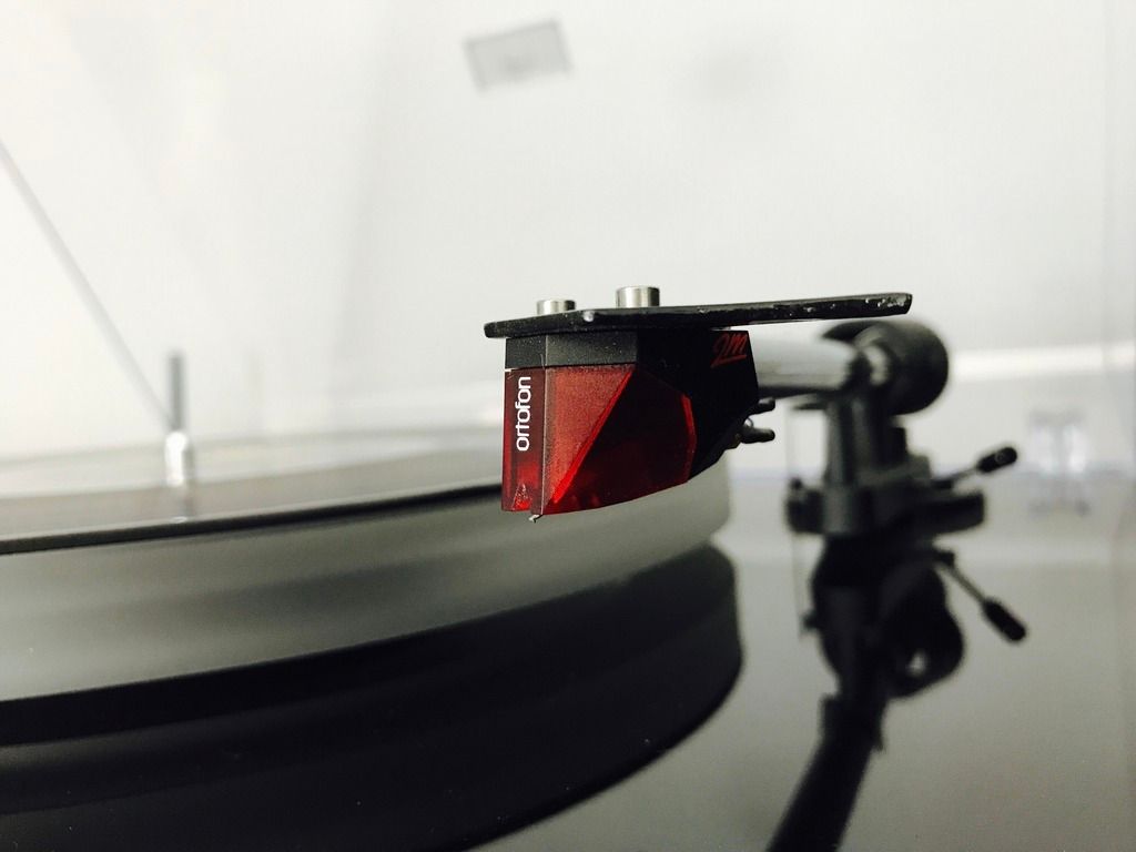

As promised in my other thread, here is a pic of the set up, and here is my needle. I don;t know how to tell which one it is, other than the assumption that perhaps it is the 2M Red because it's, well, red. If anyone knows for sure, please tell me.
http://i1264.photobucket.com/albums/jj500/ericcraigis/FullSizeRender21.jpg
http://i1264.photobucket.com/albums/jj500/ericcraigis/FullSizeRender_2.jpg
That is the 2M Red, not only it is red, you can actually see "2M" (upper right corner). It has a decent output of 5.5 mV at 1000 Hz.
https://www.ortofon.com/ortofon-2m-red-p-317
The Marantz phono input sensitivity is 2.5 mV so there should be no issue at all.
