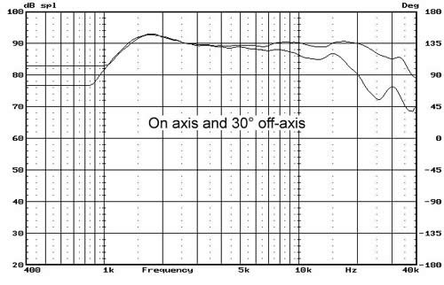

Drivers:
VIFA TC11MG-07-04 4.5" Infinity Woofer ($3.99 ea on clearance)
Hi-Vi TN25 Fabric Dome Tweeter ($8.28 ea)
Crossover:
2-way Linkwitz-Reilley. Polarity reversed on the tweeter to accomodate phase shift. These values acheive a crossover around 1900 Hz (see picture).

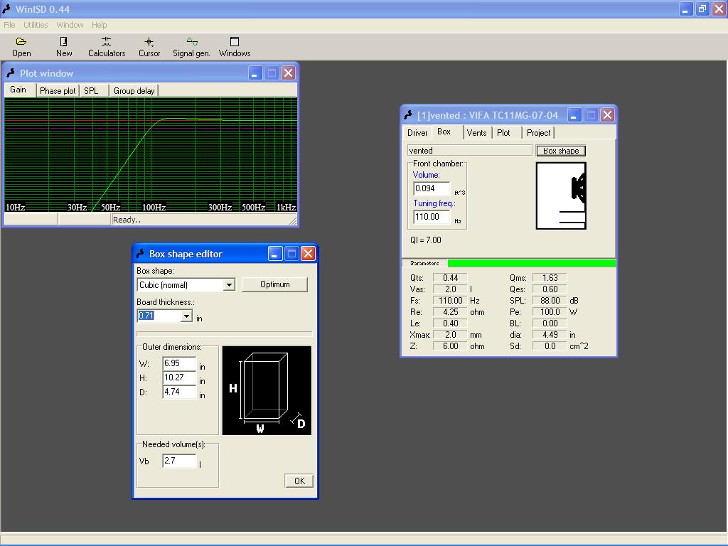

Enclosure:
I'll be using 3/4" MDF with maybe 1 cross brace. It will have a 1.5" port 3" in length on the back. See the picture from WinISD for freq resp plot and dimensions. It will be stuffed with polyfill. I haven't decided on the finish yet.
Hopefully this will turn out well. I'll let you know my impressions when it's finished!
