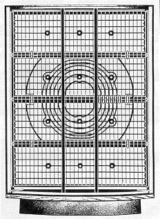

It isn't the dipole design, its the lobing that occurs on the vertical plane. All of that projected energy is interacting with itself, and it will produce a very complex comb-filtering pattern. The thing is, comb-filtering can be difficult to hear, so while the response might look like a mess, it may not sound like one. Indeed, I have heard maggies and other planars and electrostats that have this quality yet they always sounded fine.
Neither free-air or Klippel measuring systems would be able to disentable this problem. It's possible a far-field, multi-mic measurement might help though.
Exactly, and that is why Peter Walker developed those delay lines etched into the membrane of the Quad ESL 63.
They are so phase coherent they will neutralize a square wave in free air, with one speaker out of phase. Peter demonstrated that to me personally on a trip to Huntingdon. I can assure anyone this feat is NOT myth.
The Maggies do so sound fine over a restricted listening area. I regard them as an 'antisocial' speakers as there is really only one good listening position. Personally I find them somewhat akin to headphone listening.
I think you really do need to have good sound over all seats, otherwise they are antisocial speakers in my view. I personally believe that speakers with good sound over a wide area sound better and more natural anyway.

I have a friend with the original 3.7 Maggies and
1. it remains one of the most realistic sounding systems that I have heard. The op is right, though, in that....
2. it had a rather small sweet spot and.....
3. my friend spent a lot of time painstakingly tweaking the system until he got it just right. More effort than most would be willing to exert.

1. Fully agree, especially for the price.
2. Yes. I suspect that this is a major factor in their rarity in AV systems. They shine in antisocial, single seat 2ch systems.
3. This isn't really as bad it's made out to be after you come to terms with their needs. Many folks either can't or won't. And WAF is usually low to begin with. This only gets worse when she learns that they need to be pulled 4' out from the front wall!
