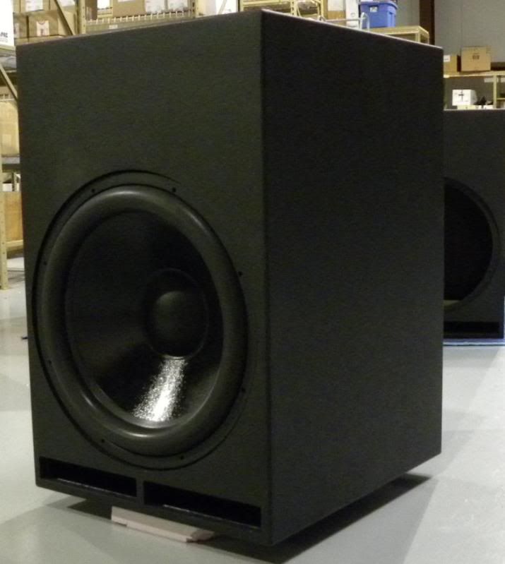

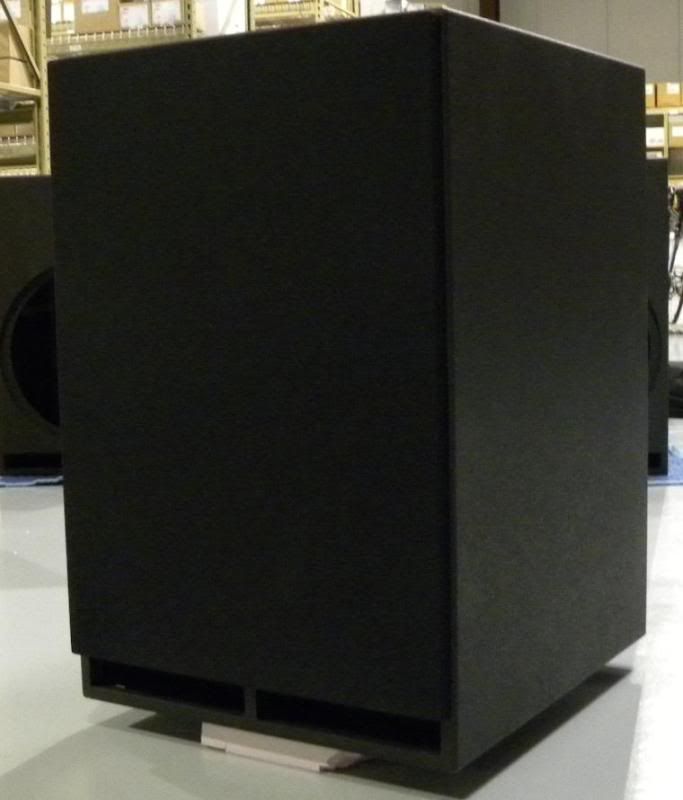

Just saw this new redesigned monster.
* massive excursion 18″ subwoofer (30mm xmax each way, 4″ peak to peak)
* Bass Reflex Design
* heavily braced cabinet
* huge slot port for minimal turbulence and compression
* completely front firing for versatility
* optional 2000 watt RMS with balanced XLR
Manufacture Direct $999
http://jtrspeakers.com/home-audio/captivator/

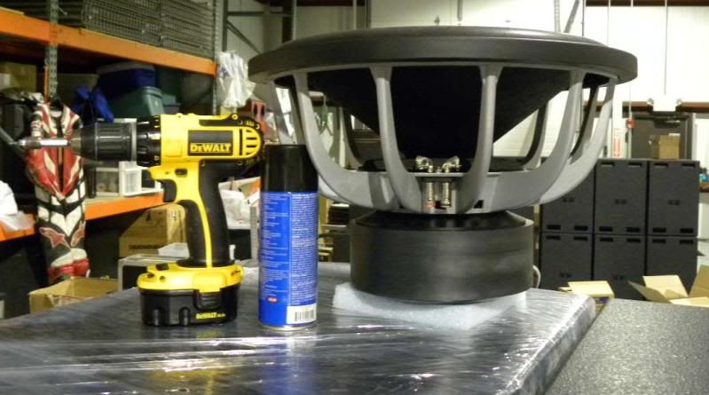

From Jeff P. of JTR:
The all new 2011 Captivator is a bass reflex design with a 18" driver that is 6db more sensitive, double the power handling and the same cost!
The 2011 appears the same as the previous model with the new cosmetic changes to match the rest of the 2011 line up (rounded over corners, flatter black and light texture). Recommended high pass at 14hz.
It uses a similar 68lb driver to that in the Orbit Shifter.

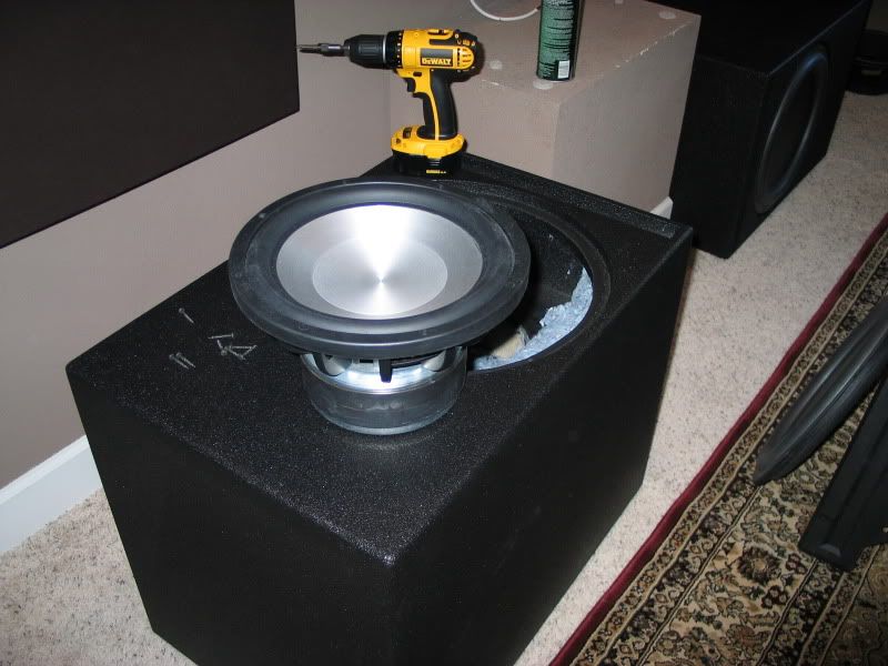

This looks like a more classic vented design. I believe the old Captivator combined an 18" passive radiator on the outside with a 12" driver on the inside of a folded horn type box or something.

It still looks like it has a PR on the outside to me. So it's now a bandpass sub like the Terraform?
It was a sixth-order bandpass, now it appears to be a standard bass reflex design with the 18" driver and slot vent.
The beefey 12" driver, 18"PR and slot port of this unique bandpass design:

So then the picture in the first post is the old Captivator?
