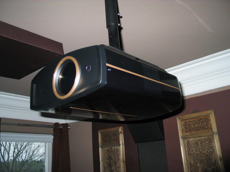

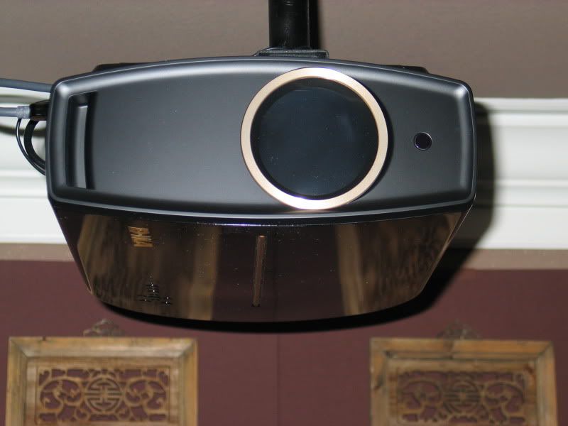

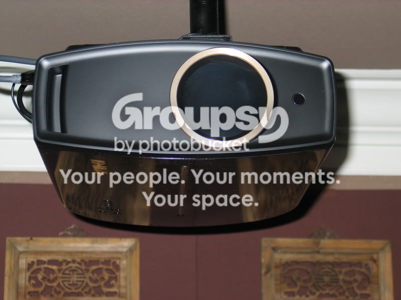

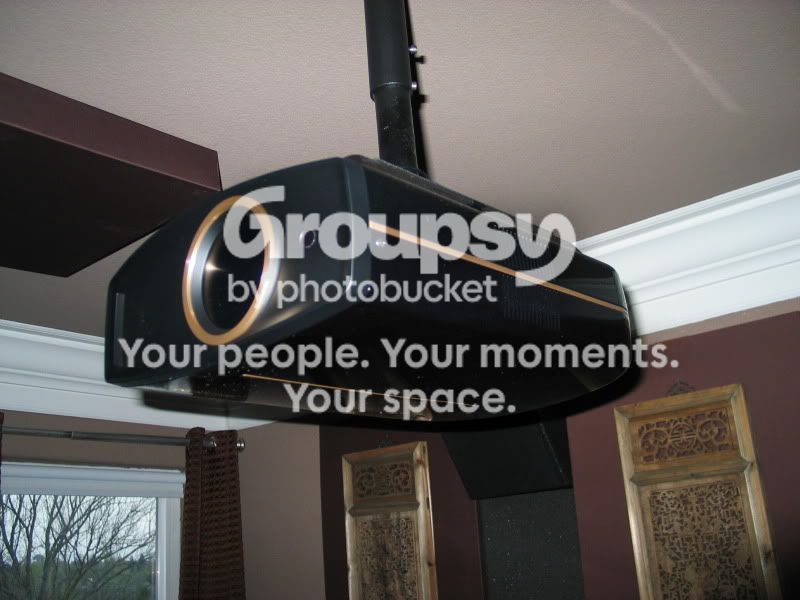

I setup the RS35 yesterday. My powered Stewart screen (StudioTek 130) is 12V trigger activated so I had an interesting couple of hours modifying the Chief RS2 mounting plate to fit the RS35. Once that chore was finished, I spent another hour trying to find the menus to activate the screen trigger, focus and to flip and invert the image while fuzzily displayed on my front wall with the plasma screen and treatments. I simply could not read the menus until I fumbled my way into the lens adjustment menu on the remote. The RS35 Manual layout is awful and IMO, poorly organized but eventually I got the image focused, centered and zoomed.
Once I got a focused image on screen … WOW! Any concern I had about the value of this “upgrade” faded quickly. I set projector to the THX mode that was recommended by several reviewers of the RS25-35 and did no other calibration or adjustment. In the normal lamp mode with my room darkened, the image was just beautiful. The RS-35 has amazing color accuracy and clarity with inky blacks and great shadow detail right out of the box. I only used bluray material as I wanted to see what familiar HD material looked like and I was blown away by the image. Admittedly, I’m no videophile but the image produced by the RS-35 is as good as any plasma display I have seen. To me, the RS35 image looked every bit as good as a SIm2 Lumis ($30K) I saw demoed at a dealer show room recently.
I still plan to have the unit calibrated in June by UMR and it will be interesting to see if I can see the improvement in PQ. Value is very subjective but considering the price I paid (don’t ask), this is one heck of a projector.

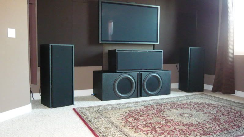

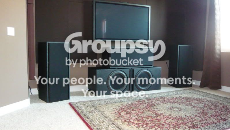

Well since you asked :p
Yes, I wanted the screen lower and my experiments with AT fabric were not good. There was a significant loss of brightness and I found the perforations and to a lesser degree fabric weave would be visible from the front row (<12' away) due to having to move the screen closer to accommodate the speakers. The new screen height gives a better viewing angle for the front row. It did force me to move the mains outboard few inches and place the Center on the subs. I am using silicon door bumpers as pads for the center and have it angled up a few degrees aimed directly at the front row head height. That combined with the height speakers makes for a very nice front sound stage. I’m sure it would be better if the LCR speakers were directly behind the screen but I believe the trade off in image quality isn’t worth that slight audio advantage.
As for the subs, they were essentially within 2 feet of each other before so already collocated so, no noticeable change there. I haven’t had time to re-run Audyssey and take a look at the SMS-1 graph so I’m flying blind at this point but it does around and look very good.

Off-axis is really smooth with the JTRs, a few degrees you for sure won't be able to notice.
