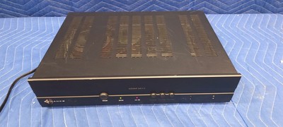

For what it's worth, if you want to really get a bit more power, the Sonance 260x3 amp is nice as it provides discrete power to all the speakers. But, it is still designed as a single zone setup.
Nonetheless, nothing as cheap as what I linked for that product. This was the cheap one on eBay...
