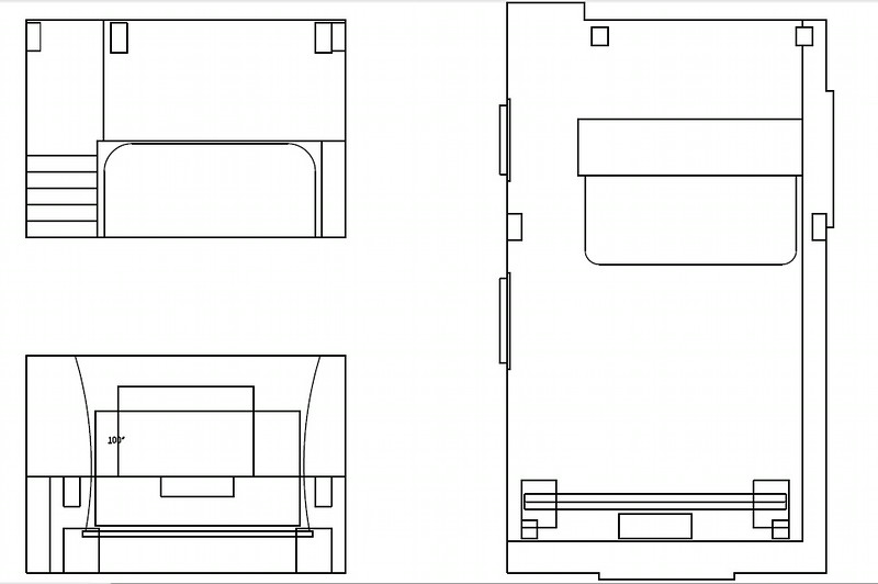

Here is a drawing showing all EMPTek speakers (E5Bi main and back, E56Ci center, and E55Wi side), dual SVS PB1000's with a 100" screen at its lowest setting.
I realize the center is behind the screen, but I just left it there for now. I could probably swing (justify) either an acoustically transparent screen, or a flush mounted, but not both. Given the choice I think I would rather have the flush mounted screen for a cleaner look when its away.
Sean

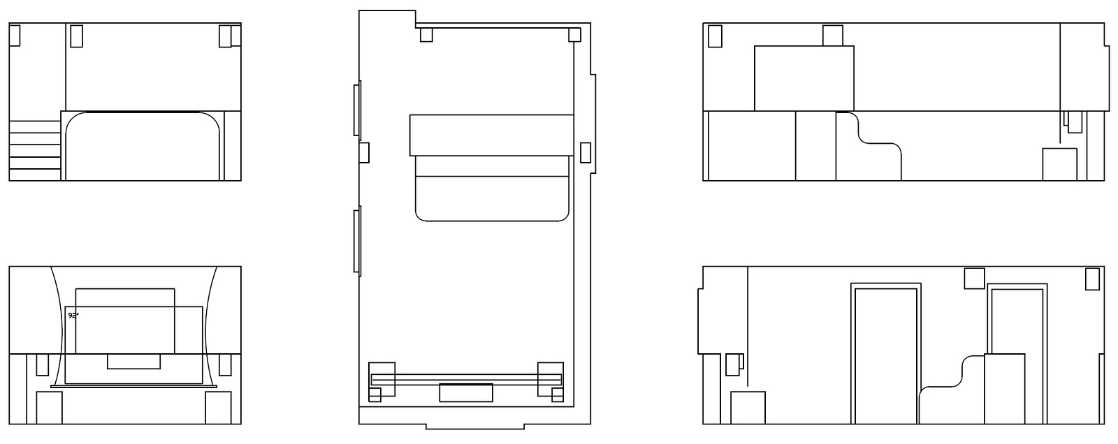

I also redrew the room with a 92" screen (ElueVision specs), the correct EMPTek speakers (with larger E56Ci center), correct SVS PB1000's, and finally fixed all of the dimensions and added the rear bump out. I moved the couch and counter/bar forward, and the side speakers back as well. I still need to draw in the correct screen, move the center, and maybe finally add some details but you get the overall idea!
So what does everyone think of the overall plan?! Again, thank you guys for all of the help so far!
