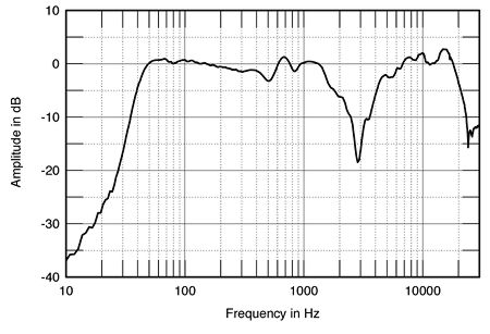

The frequency response of the mozarts is a MESS:
These speakers unequivocal CRAP! Don't be fooled by auditions with a weak frame of reference. Ten days of living with them and you'll get sick of their total lack of any upper midrange whatsoever.
Would you mind posting the freq response of one of the systems u suggested?
(That does look bad i will admit. Poo)

Their Baby Beethoven's measure like crap too with a similar drop in midrange as well. purple trace
