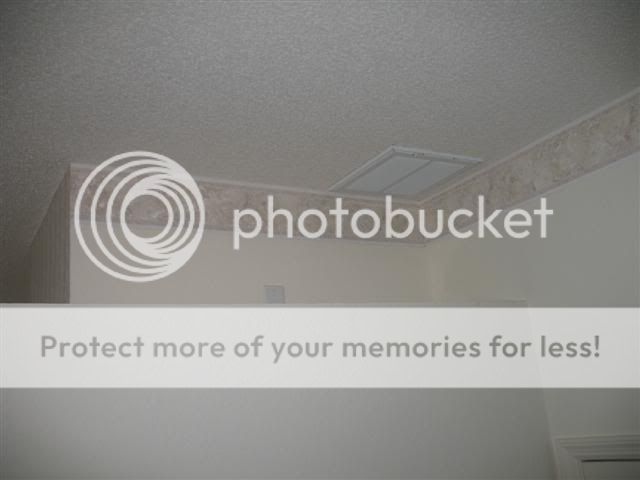

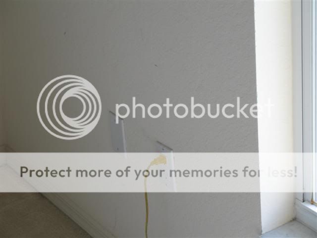

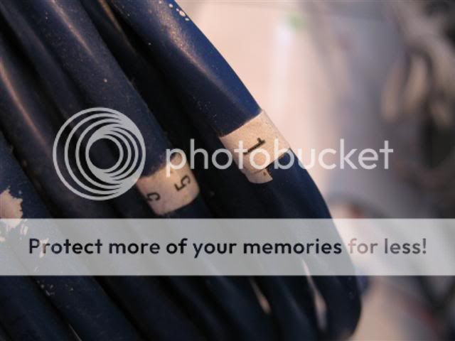

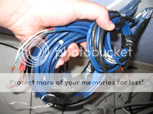

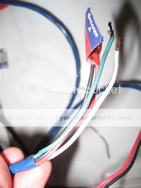

I still need one or two more posts before I can send picture links so I'll get them up in awhile. I just looked at the wires and see they are a 4 strand wire set with red, black, green and white.
I'm thinking that I would want at least a 3 zone system to allow me to watch TV, Listen to the radio out at the pool and also allow a different music selection within the house.
Am I on the right path here or am I totally off?
From the sounds of it, I think these speakers were just for ambiance and not for loud entertainment.
I would take a look at the speakers. You may have a 70 or a 100v speaker system. This is used if you don't have a high power amp. The speakers have a tiny transformer on them allowing for a low power amplifier to be used. More like a passive amplifier built right on the speaker. This is mainly used when you only have one source of speaker output, but wanted to run many speakers off of one low power output and high impedance.
EG: If you had say a 100watt amp and 10 speakers. each speaker would get 10watts... adding speakers without a transformer would make the impedance too low... Putting speakers in parallel and or series is not good practice..
having a 70v system, would mean you can add as many speakers as you like and there would be no need for impedance matching..
hope this helped...
This is extremely unlikely in a residential installation, especially when used with home-run 16g wiring.
Actually, this is most often used with a high power amplifier, but with 50 to 100 speakers run in mono from a single location. Paging systems in schools and office buildings often use 70v speaker setups to deliver audio.
It is similar to modulating video over RF and significantly deteriorates the audio quality which is why you will never find this in a residential installation from any worthwhile installer.
I would say that this is not something that is worth thinking about for how incredibly unlikely it is.
But it still could be possible.. You can't rule it out 100% until the OP tells us what he finds in each room.. He's got so many connections, I can't imagine all going on at one time. He would need a multi-room output receiver. I'm not trying to prove anyone wrong here, just does not seem logical to have so many speaker connections with a single receiver.
BMXTRIX
BMXTRIX
This is standard practice for residential A/V. All rooms are independently wired from 8 ohm speakers to a central location (head end). Then, the home owner can pick which speakers they want to use at any time or how they want to set things up.
You can buy speaker selectors, smart controls, independent zone systems, or run them all at once with impedence matching products. You can break things into 1 or 2 zones, or have each room be 100% on its own.
In ten years, I have NEVER seen a home with 70v systems installed for audio. Not a single reputable company with any home A/V knowledge would install a 70v system for music. The limitations on quality for 70v systems is pretty severe and is akin to modulating video to many TVs.
The general expectation is that the home owner will add a speaker selector (impedence matching) and an amplifer - OR - the home owner will use a speaker distribution block with an amplifier, then have impedence matching volume controls in all the wall locations.
Because every wiring run is home run, it means that if there is an issue with any single leg in the system, it has no affect on the other legs of the system.

I understand what you are saying. But with a speaker selector switch you can only do one set at a time. Having a 70v system seems to me to be more useful, as you can have a separate volume control at each location. If you are good at wiring, I don't see there ever being a problem. I've never in my life see speakers wire just fail for no reason...unless they were damaged prior to installation.
