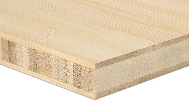

Cool. So it is a Bamboo Ply.
Thank you. :)
(edit: bamboo plywood is a little different than what we think of as plywood as it isn't the regular sandwiching of alternating layers... This is just from a quick google search:
I had seen some other descriptions that discussed rolling out and compressing the fibers in a manner that sounds more like traditional ply, but you can see with this product what looks like described above in your post. :) )
Lumber core is the term I'd use.
