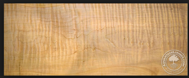

Nice looking hunk of wood, looks like your dog would like to give it a chew ! So, do you use a large
band saw to slice off the 1/4" pieces (isn't this what they call resawing ? )? Do you feed the whole chunk through or cut it into more manageable lengths first. Good luck with the process, looks like beautiful wood.
Dave
Yea, she was not happy being in the hot and sticky garage, nor was I. Correct, I will use my band saw to resaw. I do not have a huge band saw but probably bigger than the average. I was very lucky years ago to afford it. You bring up a good point; which I have been contemplating since I bought the stick. I had planned on NOT cutting the stick into manageable lengths (approx. speaker height). However, each time I did a test mock-run of cutting the in-tack stick, I felt unsure of my ability to control the length and weight. Probably could manage it, but don't want to risk it due to the cost of the stick. So probably will cut from board two lengths of at least 45". Each of these lengths will be cut into six 1/4" panels (total of 12). Each of the 1/4" panels will be divided up into veneers for left, right, front, and back faces. After all the resawing is completed, veneers will be smoothed/planned down to slightly greater than 1/4" thickness-- will leave just enough extra thickness for finish-sanding or possibly finish scrapping.
My piece should be at least as good as this one, knock on wood (figure wise, maybe a little tighter):

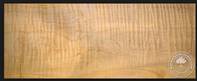

Nice ! Should be a beautiful pair of speakers. Looking forward to your finished product.
