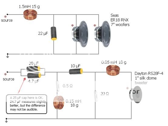

Hello everyone,
I am new to speaker building and I need a little guidance on the cross-over. I purchase the shopping list provided on this first page of this thread and it had a .10mH air core that needs to be unwound to read .06. I do not have a way to unwind and measure it. Does anyone know about how many winds would need to be removed to get it within the 10% specification of .06mH?
In the notes below it says "XX coils" but I am not sure what that is suggesting.
Any help on this is appreciated.
Shawn

To do what you want you need an inductance bridge. There are formulas to calculate turns, However the calculations turn out to be far from precise in the actual world. You always have to measure.
The real point is that a 0.06 air core choke is not expensive. Just order a couple and be done with it.

Thank you for the quick responses.
I am fine with this. Does .05 make a difference as I am not finding .06, just
a Jantzen Audio 0.05mH 18 AWG Air Core Inductor Crossover Coil from PE.
Also on the Madisound one it has a plastic core. Is this supposed to be removed before installation?
Thanks again.

No a plastic core will make no difference, since you can not magnetize plastic or induce currents in it.

I've always meant to fix that, but since writing it, I've never had my hands on a 0.10 mH inductor coil.
I have an inexpensive LC meter, similar to this one. First, touch the meter's leads to each end of inductor to make sure it is 0.10 mH.
Unwind some wire and measure again. Keep count of how many coils you unwind. As long as the wire is not coiled, it doesn't contribute to the coil's inductance. Don't cut anything until you have unwound enough wire to read 0.06 mH on your meter.
Then cut off most of the excess (leave about 6-8") and scrape away about half an inch of the lacquer coating from the new end so you can solder on bare copper.
Edit: I just read what the others said about this. TLS Guy has given you good info. If you don't have an LC meter, just order two custom wound 0.06 mH coils. Two 0.05 mH coils would be acceptable substitutes.
And yes, an inductor wound on a plastic or wooden bobbin is considered an 'air coil' inductor. There is no need to remove the wire coil from the bobbin.

Thank you guys very much. I have ordered the .05s as well as an LC meter. This gives me an excuse to buy another tool.
I hope to have these speakers built and working by the end of the weekend.

Hello-
I purchased the parts for the dome tweeter version of this speaker some three years ago & am
finally (FINALLY !) on the home stretch after long periods of neglect. Life happens I guess.
Would someone, perhaps Swerd, please review the attached crossover pictures to see
if I've got it right ? I've assembled maybe 5 crossovers all together with years in between
so a little review would be helpful.
They aren't the neatest looking crossovers but I've seen far worse. Amazing how the
assembled crossover doesn't look like the neat little schematics, at least how I do it anyway !
As I said, these are dome tweeter version. As far as I know, I seem to be the only one building
with the dome tweeter.
Thanks for looking !
David

Both woofer & tweeter boards look fine to me. I can read a value on only two of the three inductors, and the large 25 µF cap on the tweeter board. But I'll assume the rest of the parts are right. Did Meniscus supply the parts in their kit? If so, it looks good.
Let us know how they sound :D.

Thanks for the review, Swerd. Yes, ordered the kit from Meniscus, they got everything right. Hope to be
listening this weekend, I will certainly post my thoughts.
Thanks again.
