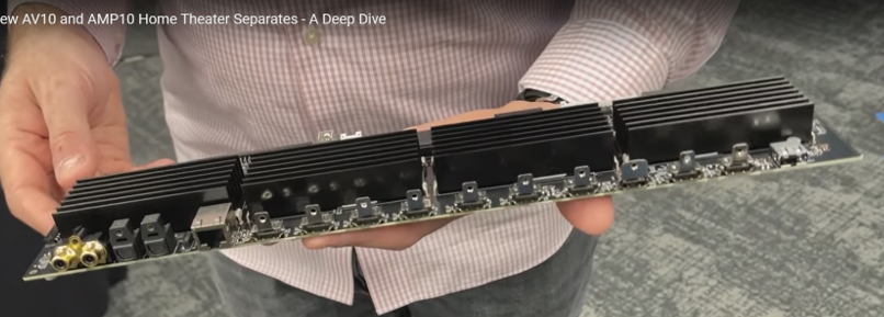

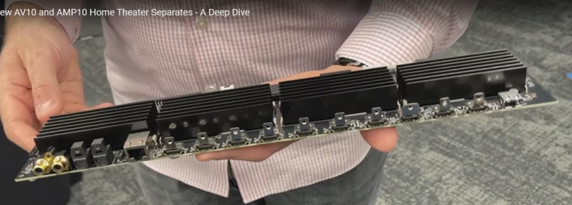

The next thing to address is, AVPs with so many channels involving very powerful DSPs that not only have too many parts to fail but also heat to deal with, just take of look of those gigantic heat sinks used in the AV10's HDMI module:
Marantz' New AV10 and AMP10 Home Theater Separates - A Deep Dive - YouTube
That's just the HDMI, in that video you can see the countless parts in this thing, any of them can go wrong, using your power transistor blow up logic.
