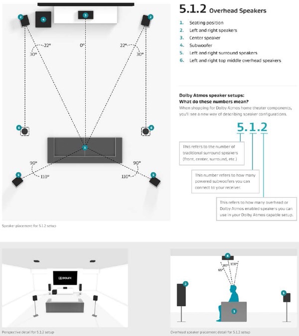

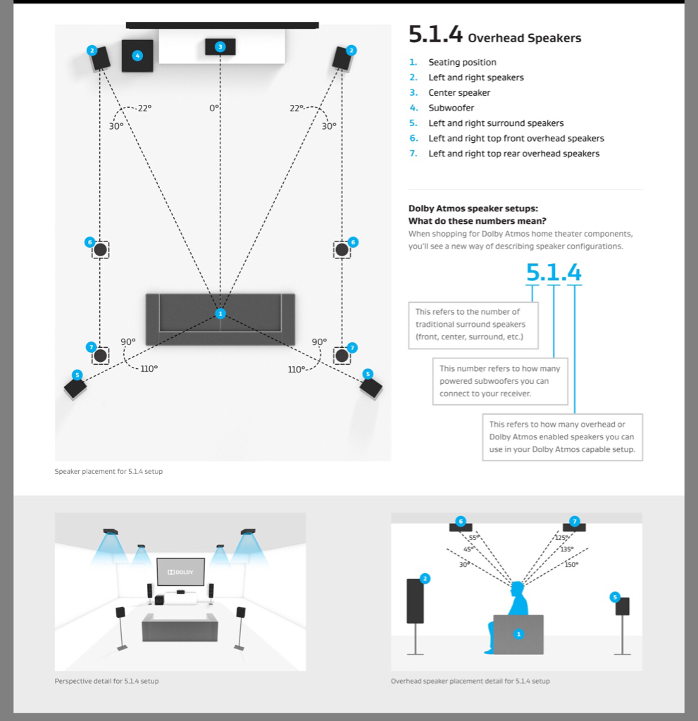

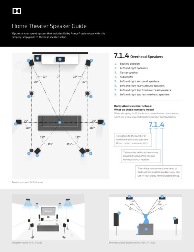

I believe the heights in a 5.1.2 setup are a little closer to the LP than 7.1.4 or even 5.1.4. Also, I need to revisit your pic but it seems rear surrounds would be problematic due to their distance. Fwiw, 5.1.4 is better than 7.1.2 IMO.
Here’s a few visual aids.
https://www.dolby.com/us/en/technologies/dolby-atmos/dolby-atmos-home-theater-installation-guidelines.pdf
The link is a great resource and if you take your time, everything is in there.

The rear surrounds in a 5.1.2 will be angled in wall. Also if I do a 7.1 the left and right surrounds will have to be in ceiling.

Ceiling speakers for bed channels in an Atmos system will be useless. I would just stay with 5.1.4 at that point. Rear surround speakers contributions are fairly subtle to begin with although that depends on the soundtrack. The reason atmos works is because of the height differential, so if they’re on the same plane, it won’t work.
