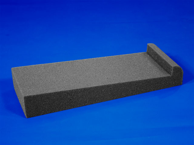

As i dont want to cut the tv screen, i have to buy stand accordingly. Should i buy angle adjustable stand? And it should be exactly in middle of tv? or i can go with wallmount stand just above tv?

hello should i buy angle adustble centre speaker stand? dont want to cut my tv screen also i dont have much space so can i just buy av rack only and put the centre on top of it but i think it wont do angle adjust

If you were to install a wall mount stand for the center speaker above the TV, I think it would make more sense to move the TV wall mount higher. It would be about the same amount of effort. I think the center above the TV would be too high. It can work and I have seen plenty of photos with the center above the TV, but ideally you want the center speaker to be close to the same height as the main speakers. Otherwise dialogue that moves from left to center to right will also move up and down. It depends on how far away you sit from the speakers. If you are 4 or 5 meters away, then the height difference is not so noticeable. If only 3 meters away, then the speakers are more localized.
If you can not move the TV higher, then an AV rack with the speaker on top, just below the TV, should work fine. If the center speaker is aimed too low (at your knees) then it helps to angle the speaker upward. You can purchase adjustable stands but even something simple like this foam wedge will work (and is a lot less expensive).

ok so tv cant be adjusted its fixed on wall. All i can do is i am buying this av rack which is 22 inches high and dali rubikore height being 7.8 it will be total 30 inches from bottom and wont cut tv screen. I would put on top of avrack will this wedge work on avrack to angle centre? Good to go? Though total height of fronts is 42 inches from bottom. will it have localization issue? can dirac live or auddeseey treat it?

So it looks like your walls are cement or concrete. That does make moving the wall mount more difficult. Keep in mind that the foam wedge will raise the speaker an inch or two but you will also be looking down on it at an angle.
