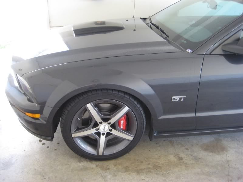

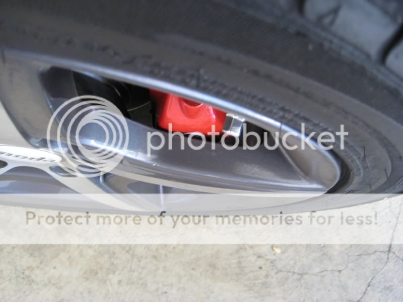

Hey fellow car nuts, I just upgraded the front brakes on my 07 Mustang GT to the 4-piston Brembo brakes that come on the Shelby GT500. Larger rotors and larger calipers = better stopping power. It never ceases to amaze me how many people work on making their cars go faster, (engine and suspension upgrades, etc.) without also upgrading the ability to stop the damn thing. :rolleyes:
The Brembo calipers come powder coated black, but my car is already so dark that I decided to paint them red.

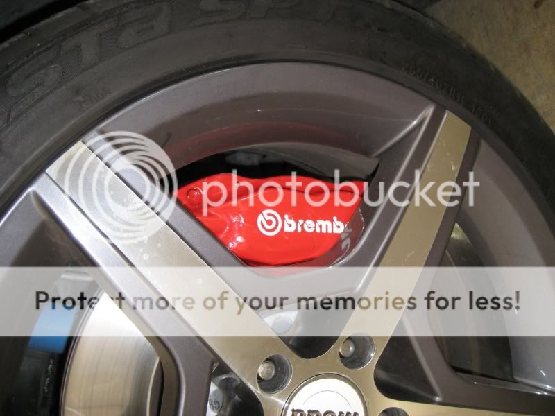

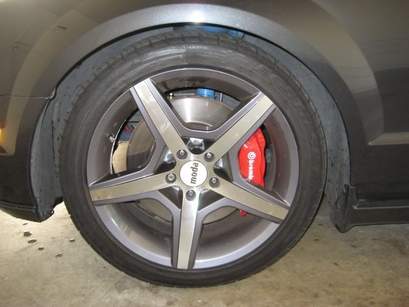

Check this out, there is barely enough clearance between the caliper and my wheels. My passenger side caliper showed a tiny bit of wear where the rim was barely scraping the caliper. I ordered some wheel spacers today to help that. Yikes.

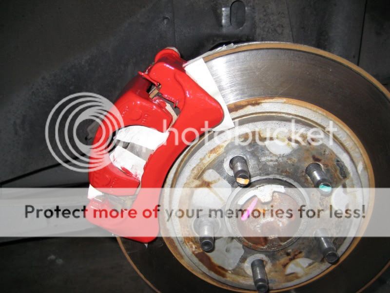

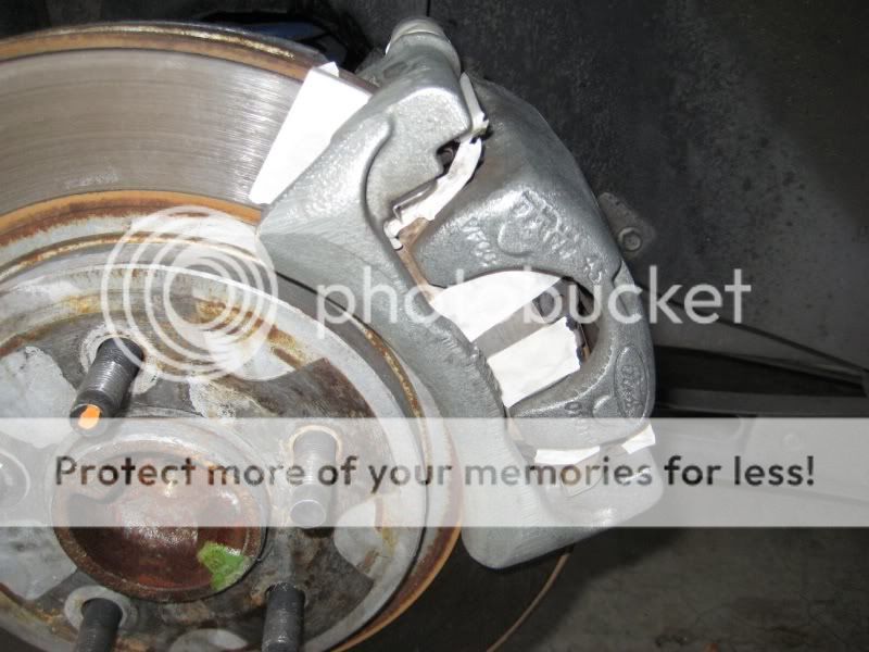

Rear caliper after cleaning with caliper cleaner and Simple Green. I sanded it a bit with 200 sandpaper.
Rears painted.
The Brembo fronts definitely make a noticeable difference. Not huge, but noticeable.

Did you remove the calipers completely to do that? It looks like you got one of the clips in the top which will make it not so easy to get out when you go to do brakes last time. Paint looks nice on them.

Yeah, I painted the fronts before I put them on the car, so that was pretty easy. I didn't feel like taking the rears off to paint them, so I just masked them off fairly well.

One of my rear calipers was seized when I bought the car so I bought remanufactured OEM calipers and they didn't have the zinc coating on them so they are oxidized now. I was thinking about painting them black. Which paint kit did you use?
Careful with them wheel spacers. I went from Orlando to Fort Lauderale in 1 hour 35 minutes (210 miles) in my 70 LT1 Corvette (back in 73). Getting off the exit my rear wheel came loose. I was using wheels spacers for my Ansen Sprints.
I think I'll be all right. I talked to Maximum Motorsports this morning and they said as long as I have 6 full turns on my lug nuts, I'll be all right. I'm only putting 1/4" spacers on.
I used the Duplicolor kit they had at Kragen. I didn't want to use a spray can kit because I wanted the extra control of painting with a brush.
http://www.amazon.com/Dupli-Color-Caliper-Paint-Kits-Red/dp/B000B6AF80
There's a kit from G2 that I've heard of, but that one requires you to add an activator to the paint. You have to hurry up and paint the calipers because the paint hardens up in an hour or so. It may be more durable than the Duplicolor though. We'll see how well the paint lasts.
Tire Rack sells the G2 and so does a buddy's shop. I might give the duplicolor a look. Plus, I get triple points if I order on Amazon :) Not going to put too much into this car as I am likely to get a newer car this year and will most likely be selling this one. Just did timing belt, cam seals, A/C, and of course brakes all of which cost about 2/3 what the car is worth right now, but it runs great :) Just has a lot of miles and I need something a little bigger.
