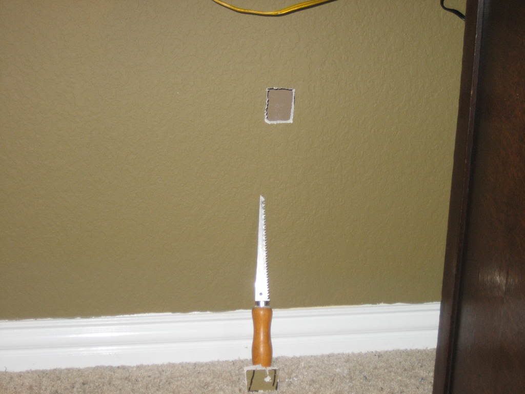

Here is the hole in the office wall where the ethernet cable will goto the router. This would be easier if I had a helper but everyone is working. Fishing it alone will cause a lot of trip up and down from the attic.

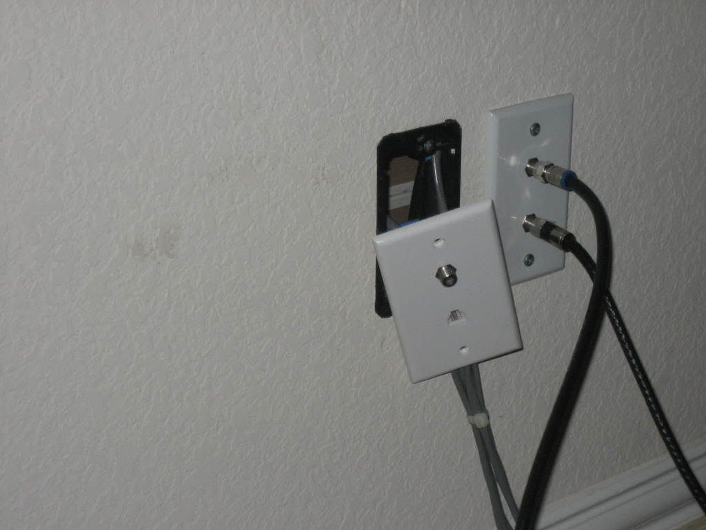

This is where it will come out and plug into the AVR>

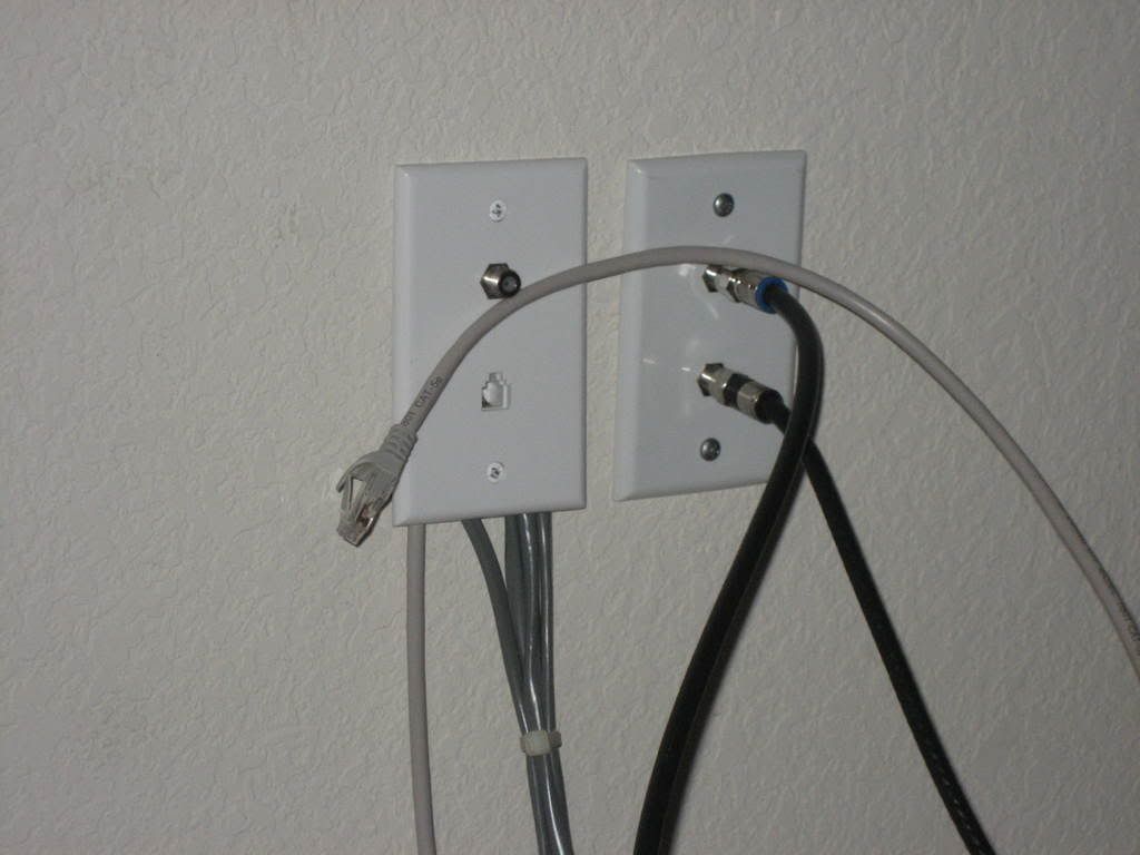

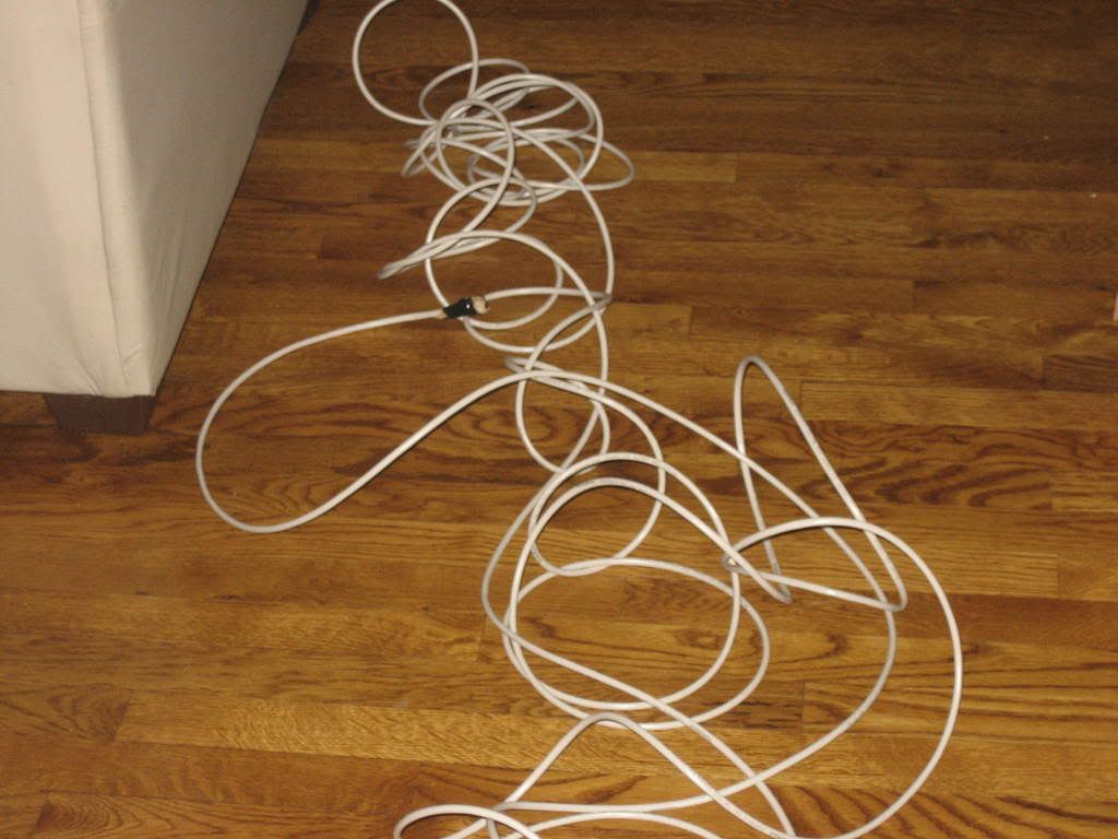

Here is the cable.

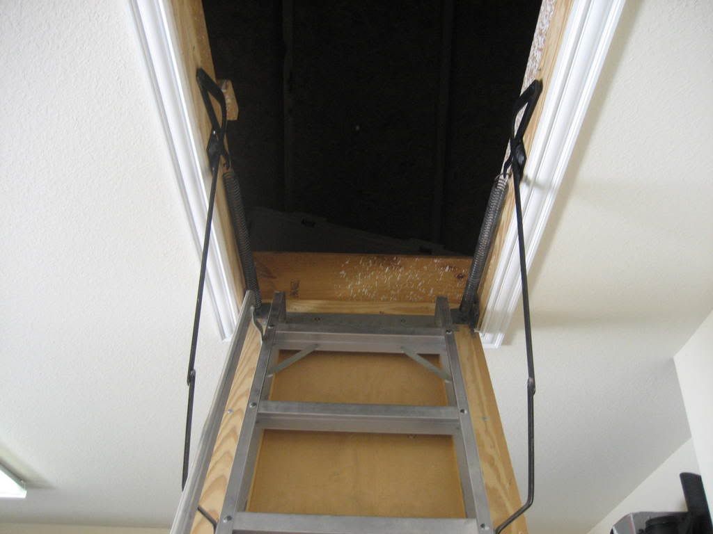

I am headed up to drill the first hole through the header and see if I can fish it down.

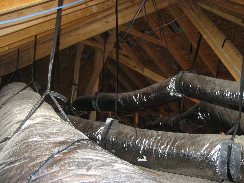

Ok, here is the trip up. I put 2 flood lights up so I could see.
Wouldn't you know it, the header was right under an airconditioner duct. Luckily, I pierced a small rod, with an orange flag on it, through the ceiling right by the wall I need to drill so my "spot" was easy to find.
Once I got up there the drill bit I had was to small for a hole to handle the fish tape and cable. I did an unweighted drop and hoped for the best. I have never had this happen before but both ends dropped perfectly on the first try. A cut off coat hanger was used to grap the cable from the new holes in the wall.

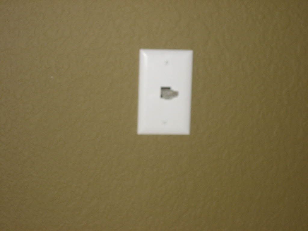

And there it is boys and girls.
Home Depot didnt have the face plates I wanted so this will have to do for now.
And yes Gus, I could have went wireless or I could have purchased Denon's wireless stubby but I went the free route!
This looks a little tacky but it's behind my credenza so it will never be seen.

Well there you go another job done. What plates were you looking at? Are you going to cut the wire and use keystone jack? This would snap into that plate.
