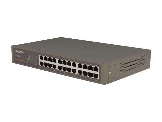

I have found that most switches do a reasonably good job for home networking if you are just looking for a basic unmanaged switch. Yes, those switches from Netgear, Trendnet, TP-Link, and others, do just fine.
I agree that having some room to grow is good, as is having a PoE switch. But, at the very least, ensure it is gigabit.
So, something as inexpensive as this should work just fine:
Maybe something like this to add PoE power to things...
I only have a couple of PoE devices, so I opted for a non-powered switch and I use PoE injectors to save money. It's worked just fine for me over the years.
