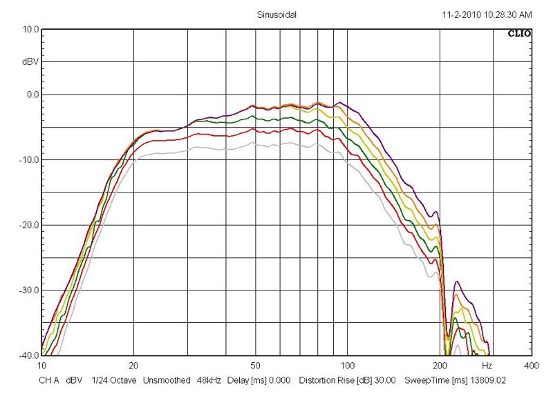

SVS does bring a lot to the table, but If you're looking for value, DIY will still be best bang for a buck and this design (see below) will probably trump most SVS offerings as far as output goes
Tuba HT
Original Tempest Classic 15" sub is apparently dead, but according to forums Dayton DVC 15 is almost perfect copy
Tuba HT

Great another option. j/k. Do you have to use that sub, or can you use a better one. Parts Exp. had a ton of offerings in the sub dept. Also, do you know what amp you use.
Has anyone on here built one of these? Any pics?
http://forums.audioholics.com/forums/diy-corner-tips-techniques/60906-tuba-folded-horn-ht-subwoofer-build.html
http://forums.audioholics.com/forums/diy-corner-tips-techniques/77482-tuba-ht-using-15-rss390ho-4-a.html
Oh, did I mentioned it is big? :rolleyes:
