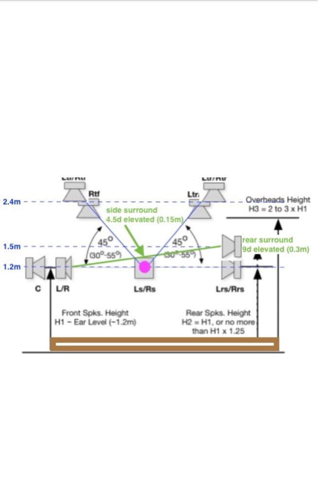

Actually taking seating out of the equation(which is aided by moving them up a bit as you said) I believe the spec is H2(surround) is equal to H1(mains) or no more than H1x1.25. Mine are like H1x1.5 at 38” main tweeter and 57” side and rear surround tweeter height.
The norm has become to go a little higher than H1 for exactly what you said. Seat backs and other heads.
