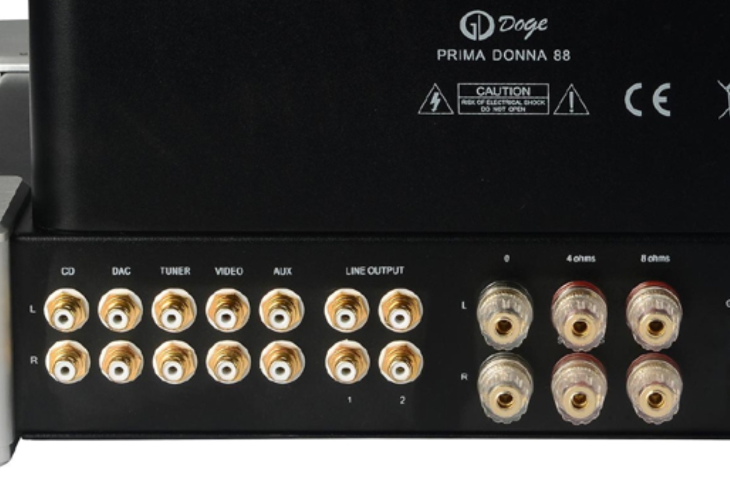

Preface: I own a Rotel A12 integrated amp which I currently run into my KEF LS50s and Klipsch RP-600m speakers. I recently purchased a Doge 10 tube amplifier as I have decided to get into the tube world. The Doge tube amp does not have an internal DAC however my Rotel does have a Wolfson DAC. The Doge tube amp has the following RCA inputs on the back panel: CD, DAC, TUNER, VIDEO, and AUX.
Question(s): My Rotel A12 unit does have a pre out on the back. Do I connect the Rotel pre out to the Doge amp DAC rca input? Or do I use the AUX rca input on the back of the Doge amp?
I'm basically wanting to know can I use the
Rotel to play my digital music (it's Bluetooth enabled and has a USB input) and send it through to my Doge 10 tube amp? I could always buy a new DAC for my Doge 10 but I'm wanting to save money here and utilize what I already have available. Thanks for your time, help, and patience.
Also, I'm attaching a few screenshots of the rear of both units for a reference point. Thanks again.
Yes the Rotel could act as pre-amp using the pre-outs, using any but a phono input on the amp...you'll need to set an appropriate level on the tube amp, best to use the volume control and selector of source on the unit acting as pre-amp.

I would use the Rotel as my control amp to drive the Doge, as lovinthehd said. You might want to set up an A/B speaker switch to see if you can hear any difference!
